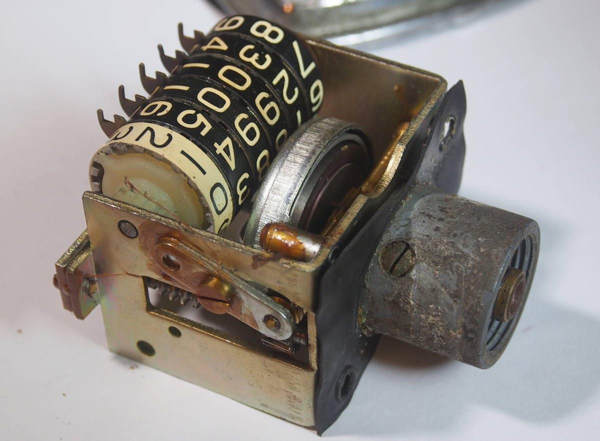

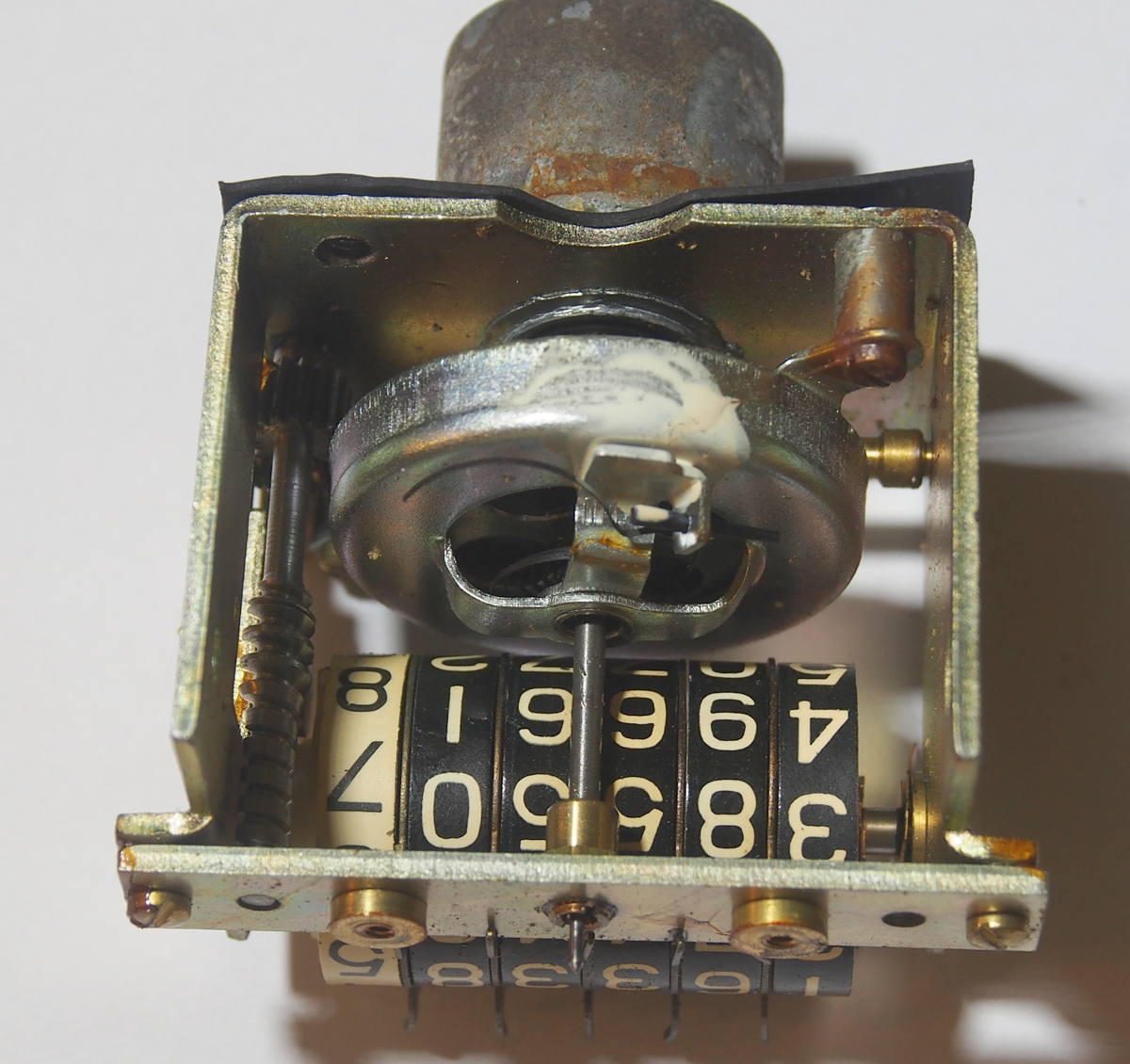

I can see another reason why the Yazaki went out of fashion. I just dismantled one and the mechanism is more complex and better made than the later units.
The gasket for the glass is better (and intact!). There is even a gasket for where the mechanism sits in the case. You can even dismantle the input bearing as it's held in with a grub screw.
I'm going to restore this one for my 1960 C77.
My guess is that Honda just wanted something cheaper.......

G, I am convinced. That is a compelling assessment.

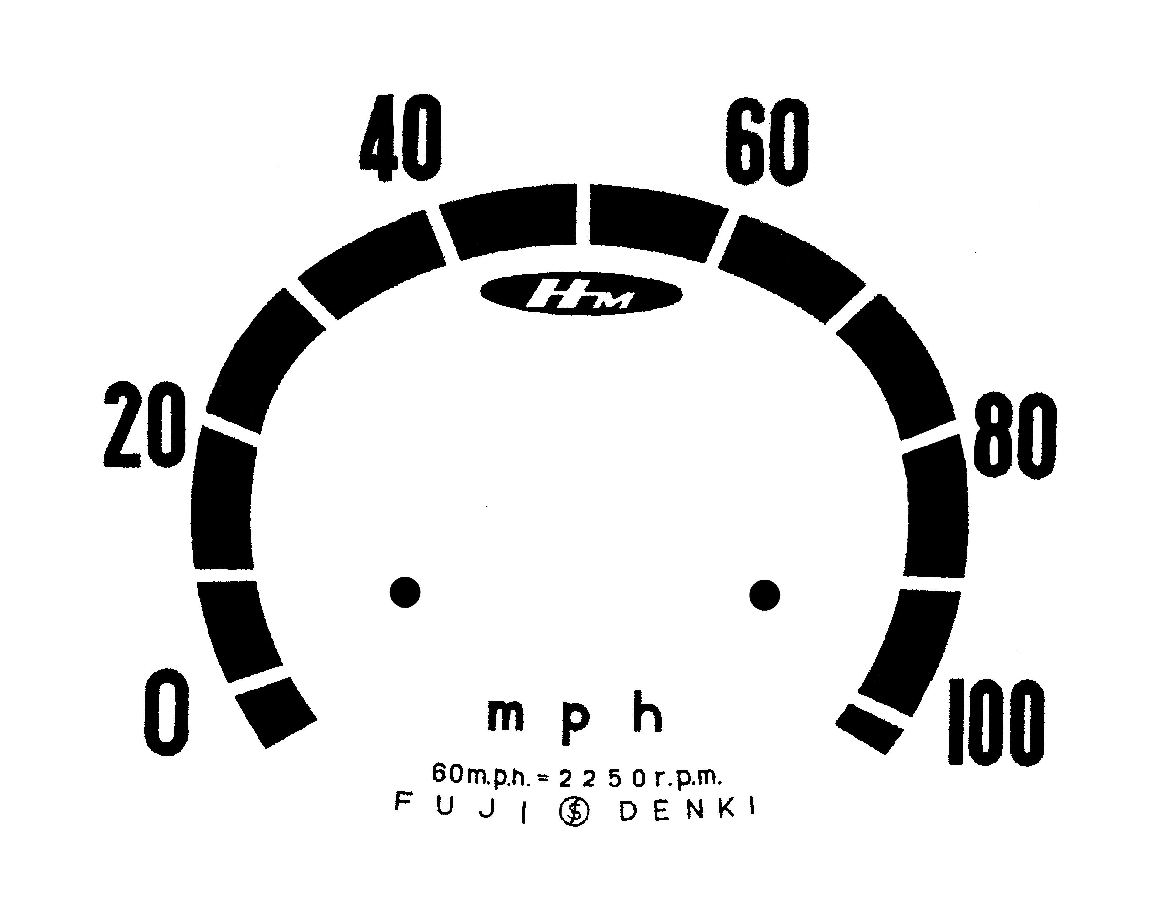

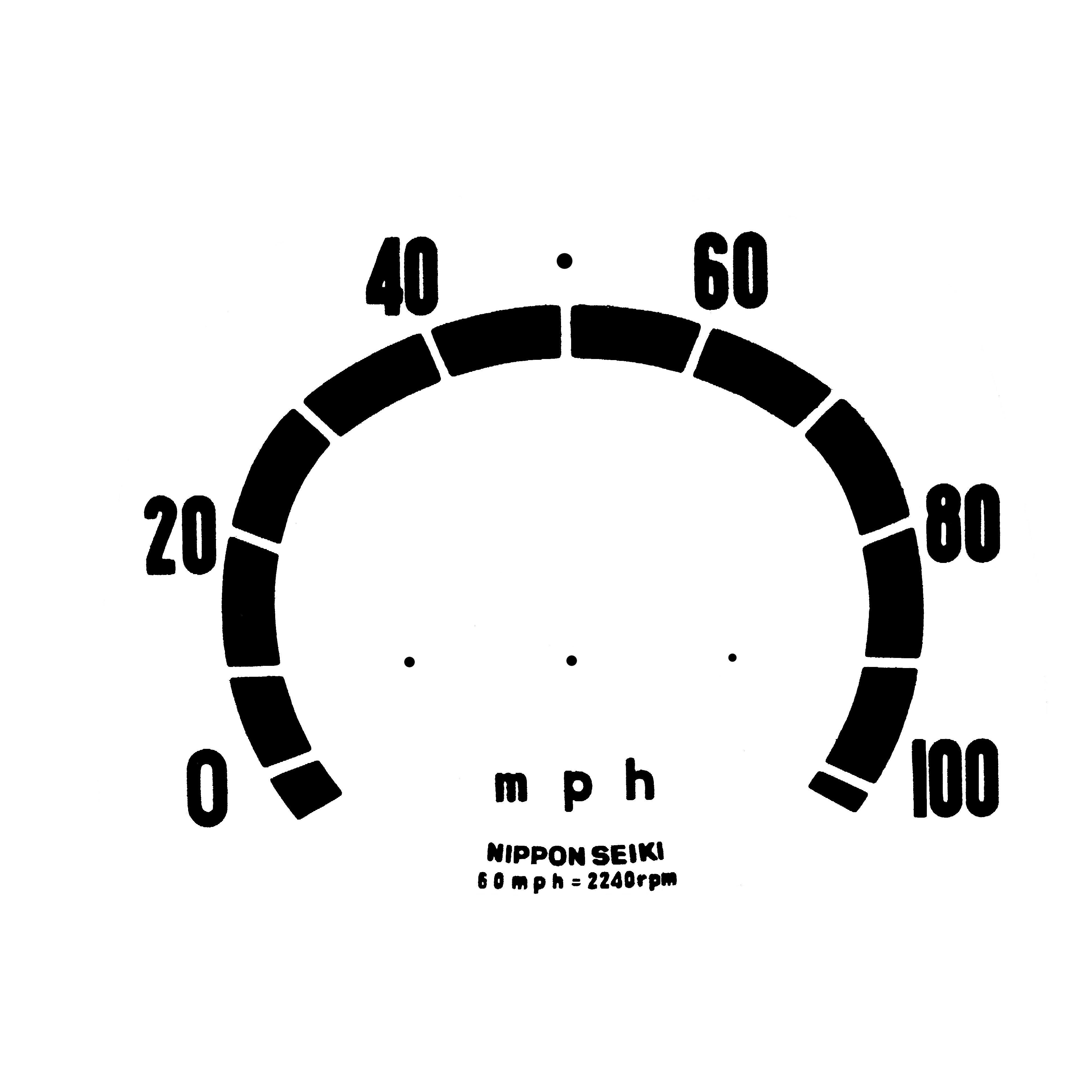

Hope these help anyone wanting to make their own face. They were both made from scans at 1200 dpi. Use the screw hole marks for alignment. You can give the .jpg to a printer and I believe with the right equipment, he could make a transfer or decal for you easily.

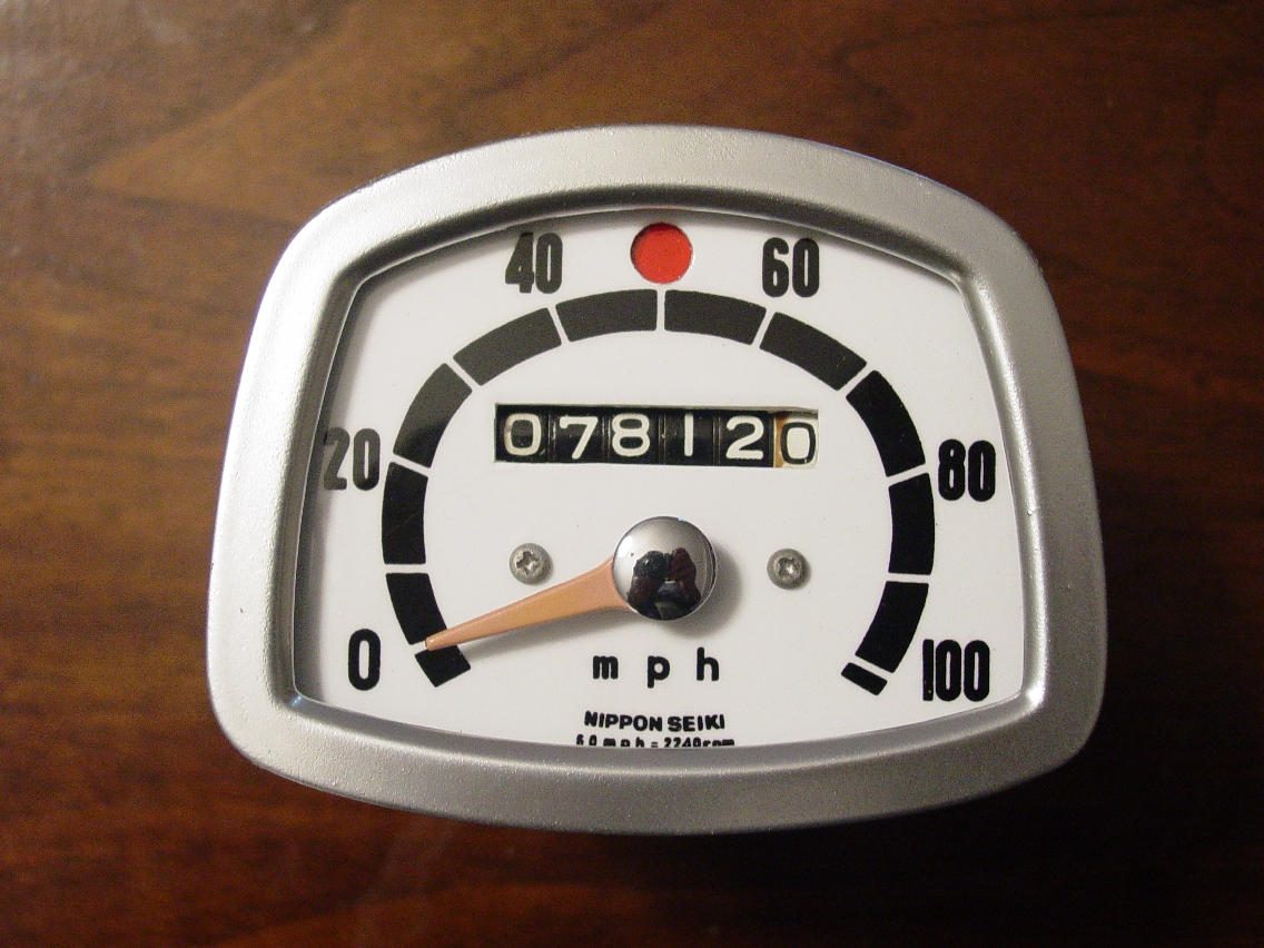

I made an inexpensive face using an inkjet and glossy photo paper. After gluing onto the face and cutting out the openings, I sealed and fixed the ink with clear acrylic. Lacquer won't work and will run the ink... at least that's what happened my first try.
I don't know if it would work for the purpose of a reflective face but Duplicolor make a clear reflective paint: http://www.duplicolor.com/products/niteLites/ .

Rich, Thanks for posting these. I am sure these will be helpful to many,
I understand from my printer that the file he would use needs to be a vector file (.ai or .eps) to make either a transfer or decal. But, they can probably make the right file from what you have posted. The 2 printers I talked to seemed to balk a little at the idea of a flat vinyl. I have a concern that if a decal is too glossy, a guy might end up with a weird reflection between the glass and the glossy decal. Also, I remain concerned that over time a decal might lift up around the hole for the odometer. So, I am still leaning toward the transfer, but am working on the background for now. And, I am probably too anal about it for my own good.
I am having second thoughts about the Duplicolor reflective paint. A white background coat with a light mist of the reflective clear over it might do the trick. For, now, I want to try the mica powder a couple of different ways. Though my first effort didn't turn out, the reflective nature of the mica powder is about right. I just need to end up with a more white color.
Again, thanks for posting these. Your speedo turned out really good. Did you make that bezel?
