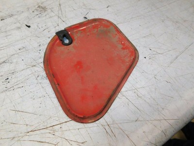

Does anyone have one or know best way to make one? thanks Choctaw.

If you mean the rubber protection where the wires come through the cover door, I made one using a length of soft pvc tubing and just ran a blade down one side along its length. I then slipped the cut edge over the cutout in the door.
