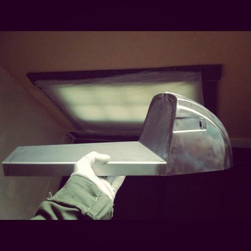

P.S. Made the cafe' seat out of the ass end of a spare cb77 tank (not upholstered yet)

The seat is looking good!
