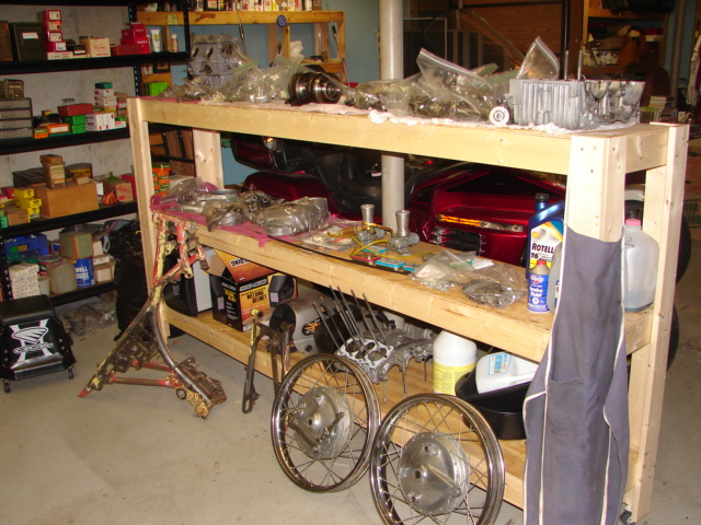

This is VERY interesting ! I am really getting started on my '66 Super Hawk cafe project, and had sourced a headlight with an H-4 bulb. I was wondering how I was going to keep everything lit up and charged. A possible alternative here ? LED's on all corners of the bike possible ? Being electrically challenged, I am looking forward to getting my horizons expanded. Keep us posted. (Just out of curiosity, is the cost of such a setup expensive ?)
(see attached photo of project in its present state.)
