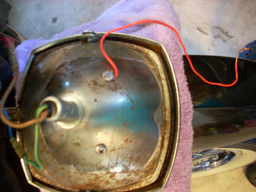

I opened up the headlight to replace the neutral lightbulb (hoping that's why its not working) and I found a red wire wrapped around the screw of the head light that's not attached to anything. I also found two other wires that weren't attached. One is yellow, and the other is kind of white-pink. Any ideas what they are for and if they are supposed to be attached to (maybe each other?) The brights work, but the low beam doesn't work. I'm horrible with all things electric. I have a wiring diagram, not that it helps me at all!

Kigs - I don't recognize that headlight, but I'm only familiar with the CA72/77. The Dream headlights should have red and blue wires for the hi and lo beam and a green ground wire. The yellow and pink wires come from the dynamo and rectifier and should connect to yellow and pink wires from the "combination" (ignition) switch in the big connector in the headlight shell. Study the wiring diagram a little. The colors are on there, but if someone has "customized" your wiring the colors may not match and you'll have to do some detective work.

My bike is a '62 Dream 305 CA77. It looks like the original headlight. The high and low beams are working (I forgot about the dimmer switch on the handlebar) This bike is SO different than my Yamaha but I'm learning a ton! I know the PO changed the speedo. I don't know if that had anything to do with the wires. I got her running yesterday and she sounds nice and strong. I'm still going to take apart and clean the carb, gas tank and do an oil change. I'll try and study the wiring diagram some more. I've never been good with electrical stuff, but I guess its time to learn! I'm hoping that maybe they are extra wires to hook up turn signals....I need to add them. Thank you for your help!
Post by davomoto » Thu Nov 03, 2011 9:27 am
The red wire screwed into the headlight has been added by a PO, and was used for a ground. Honda uses red for positive, so a funny choice of colors! Pink and yellow are from the stator, not for turn signals. I suggest following them, and see from where they origionate!
