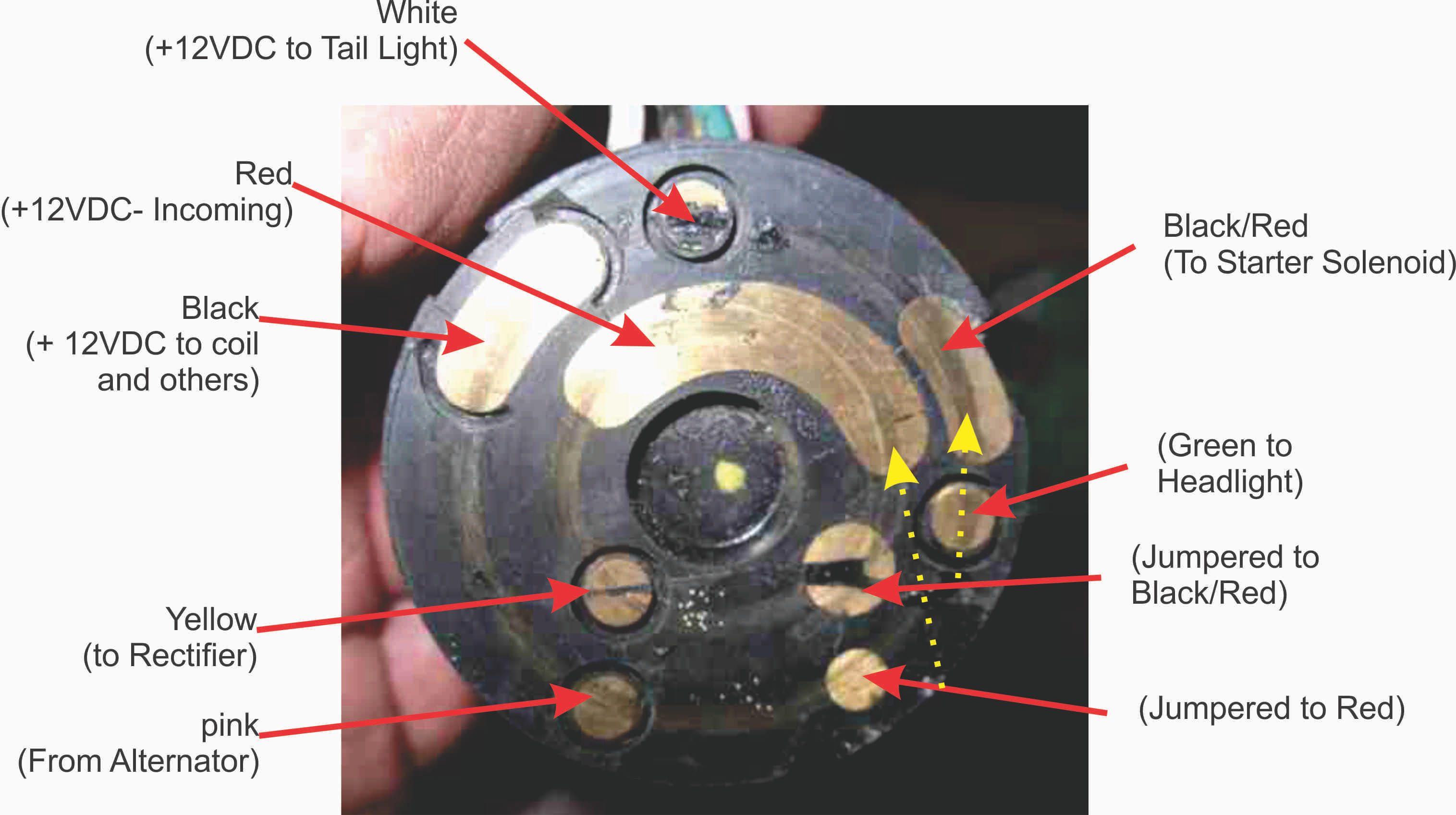

The first problem is that all the wiring diagrams I have show a black/yellow from the tail light pin on the back of the switch. I have two ignition switches both have a white wire for the tail light which follows all the way back to the light.
Anyone got a diagram with the white wire??
Here's a pic of the backside of the switch.
