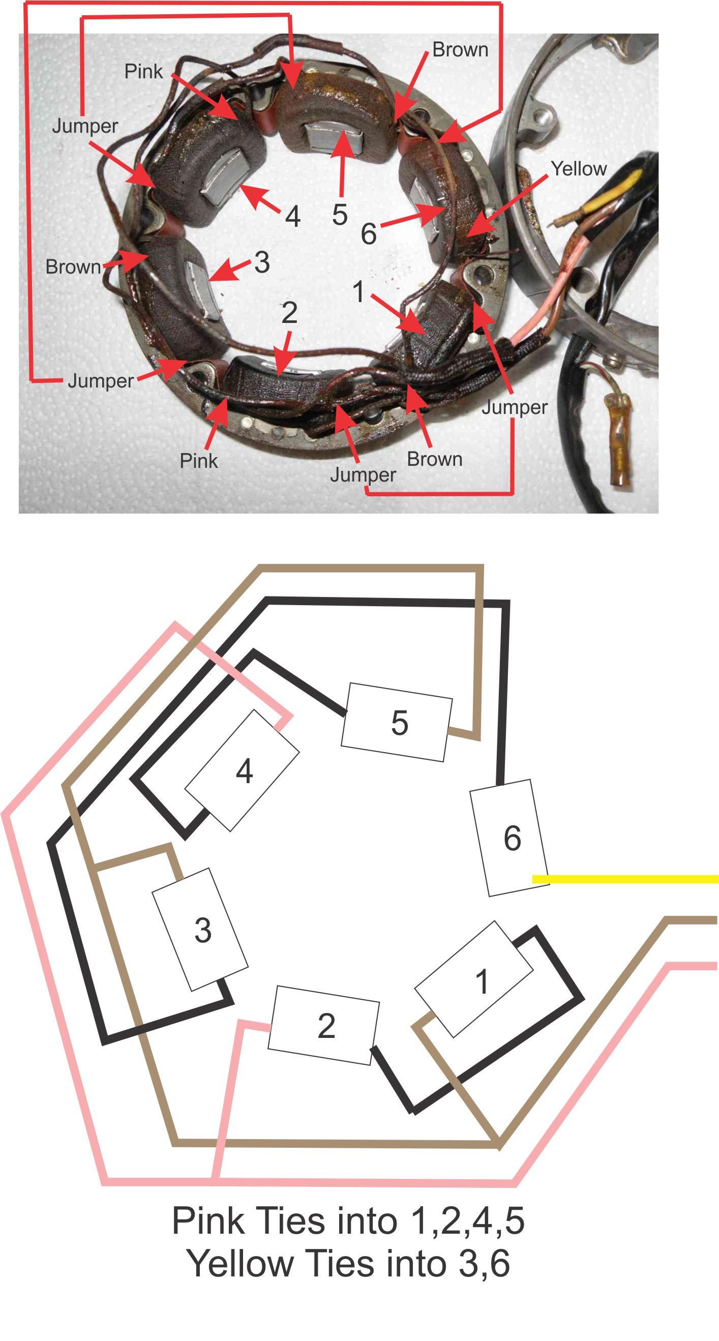

Still working on Charging System - Diagram
Post by cadman » Thu May 23, 2013 8:21 pm
I now have two stators - one from my CA and one from a CL. Still don't think I am getting enough AC voltage from the stator. I have tried a Kohler regulator/rectifier which seems like it might work (currently waiting for another one since I "cooked" the first one). Currently running a Radio Shack rectifier to see how it works. (this has been documented several times but has no regulator). Contemplating a rewind of the stator to try and raise charging voltage. Seems almost nobody currently does this.
Below is a piicture and diagram of the stator and how it is wired (If you find an error let me know) . Any help or advice appreciated
