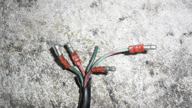

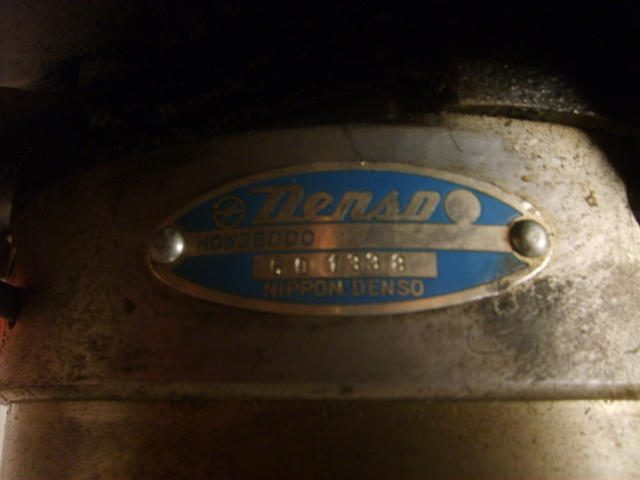

I have a 1964 C78 and with a 4 wire stator (Denso HDW3800)
My stator have's 4 wires: Yellow, Pink, Brown and green (also lightgreen/red for neutral)

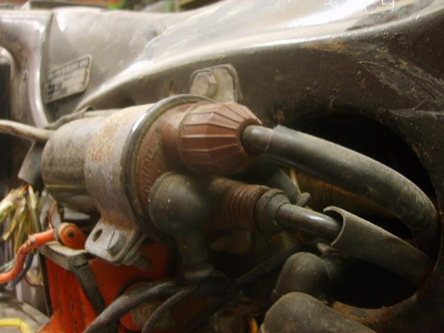

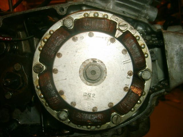

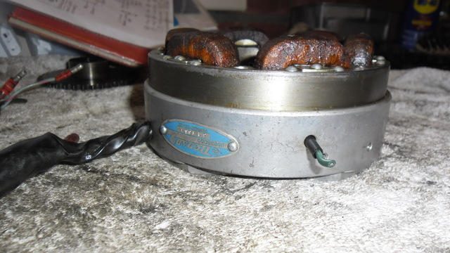

The 4th (green) wire came out of the stator and is cut, on that place are also two M3 tap holes. (if you look good you can see them under the green wire on photo 2)
The green wire goes to the coil on the frame and is there cut too..
Is there anyone who can tell me what the function is of the extra green wire and what's missing on the outside of the stator
I do not find any wiring diagram with the extra green wire on..

The higher rate of charge used the 3 origional wires and the headlight switch at the headlight bucket.
If the high/low switch is able to be stopped at center you actually light both fillaments. (switch was later changed in design so this wasn't able to be used)
You won't find a wireing diagram for that wire as it's not original.
Until you turn on the HL the switch on the bars isn't supplied voltage.
(high and low)
I have a drawer full of HONDA wire trimmings and can add then at any time.
Isn't that wire cut at the stator? .........lm
(high and low)

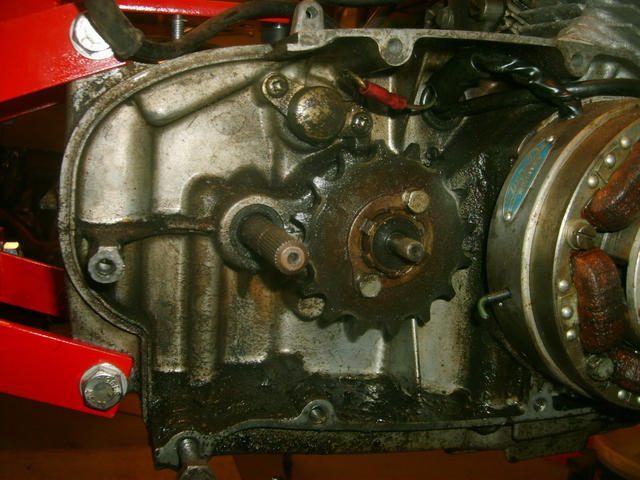

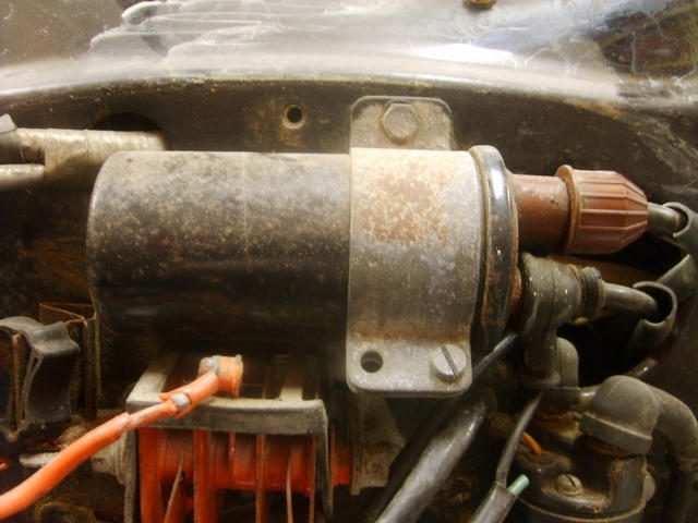

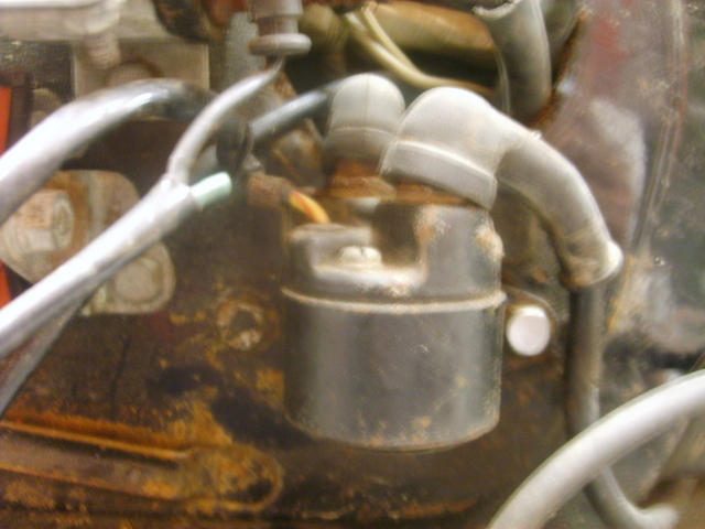

Here some extra pics about the green wire, dynamo and coil
Detail picture from the coil will come..coil is now at my fathers workshop for testing..
The wire is cut on both sides, dynamo side and also coil side..
That's the strange part of it, why it is cut and why is it there??
It lookes factory original and that strange too..
