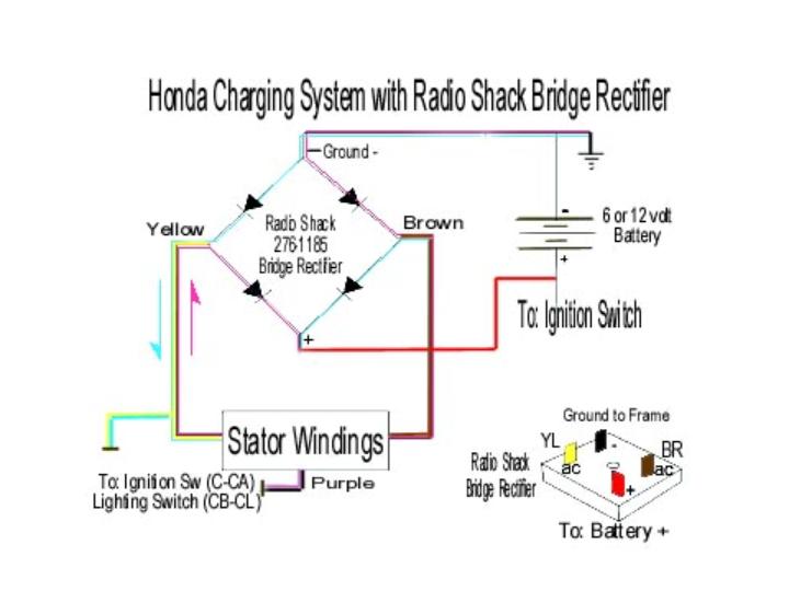

Regarding the rectifier upgrade, I compared my S90 charging system to the CL77 and they are identical, wiring-wise. Might be a wire color difference here or there on some models, but where each wire goes is identical. I was not sure if a rectifier upgrade instruction existed here for the 305's. If not, I have one from the S90 site that makes it simple, even for the electrically challenged. Here's the diagram. Do you know if we have a write-up for this already on the site. If not, I'll make a sticky with the write-up and include the diagram.
