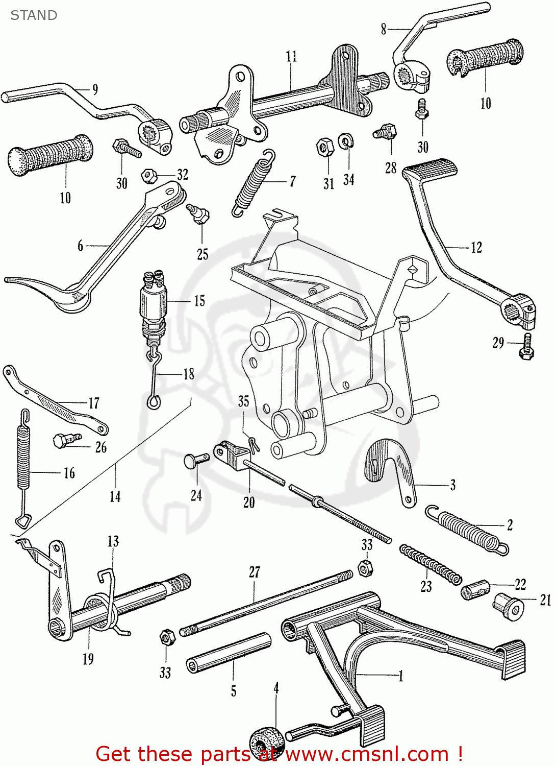

The issue is that whenever I use my foot on the lever, it moves the pin upwards, not downwards... !?
-Sascha
Post by brewsky » Mon Dec 13, 2010 1:58 pm
Sascha wrote:Guys,
-Sascha
Not sure how that could happen.
Look at the Main Stand, Step bar diagram in the parts book (pg 68) to see how it should be aligned.
The spring is connected to the rear brake spindle, and the stop switch arm. The switch is connected to the stop switch arm with the stop switch rod.
The rear brake spindle should be aligned at 12:00 position.
