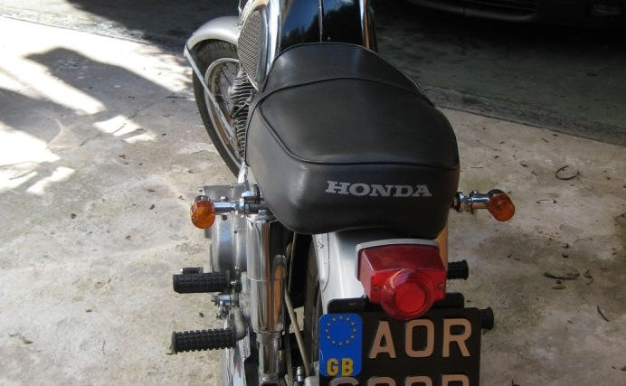

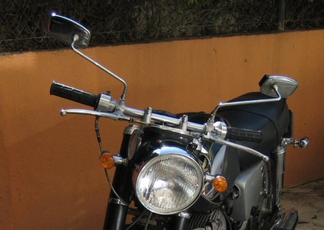

A few posts on this subject in the past; so I thought I'd take some pics of my inherited winkers, after refitting/re-wiring them. These are similar http://cgi.ebay.com/ebaymotors/YAMAHA-V ... 394wt_1055 but have plastic bodies. I bought a set last year, just for the lenses, which are the same as the ones I already have. The plastic ones are OK, especially for the money!
Flasher units (relays) are freely available from most bike shops. Both 6V and 12V.

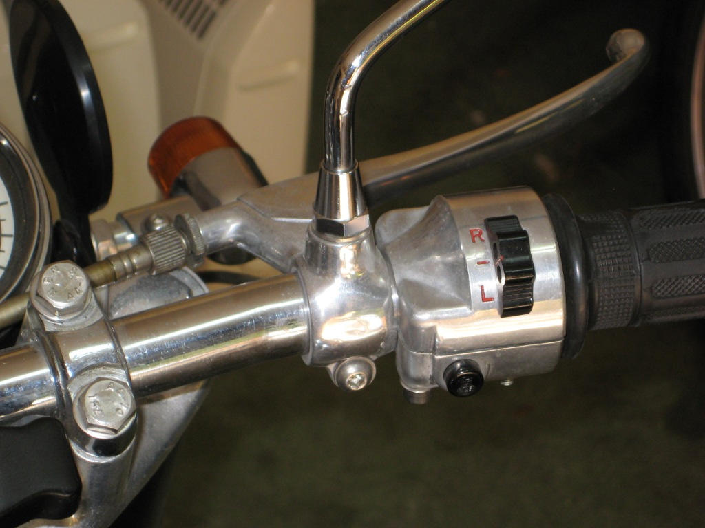

The switch was the most expensive (and rarest) item; $200 from Japan!

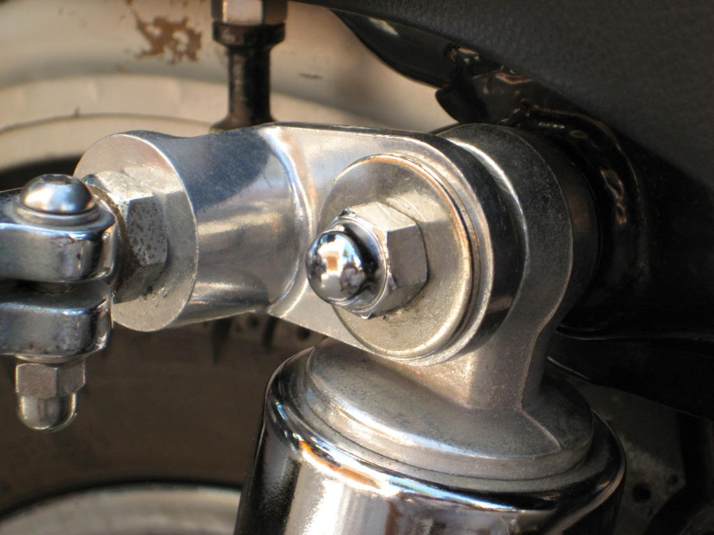

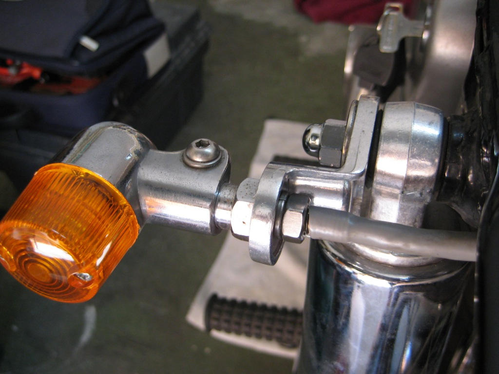

The brackets came with a set of AM rear footpegs from thor212 on eBay. I couldn't use the pegs, but they are dinky. The brackets worked a treat after a bit of adjustment, partially countersinking with a 16mm countersinker, to fit over the upper rear suspension mounts. The grey tubing covering the ends of the studs and the wires is just a stripped-off length of multicore cable jacket.
The fronts are just in place of the headlamp bolts. The plastic ones probably won't have long enough studs, so drilling & tapping a pair of bolts with an M8 thread would be the best route.
Just some ideas for the pot.
