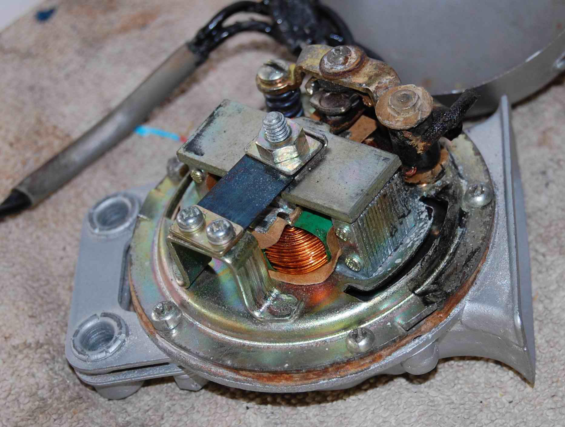

Taken right after I stuck it on. I didn’t take any pictures of putting it back together.

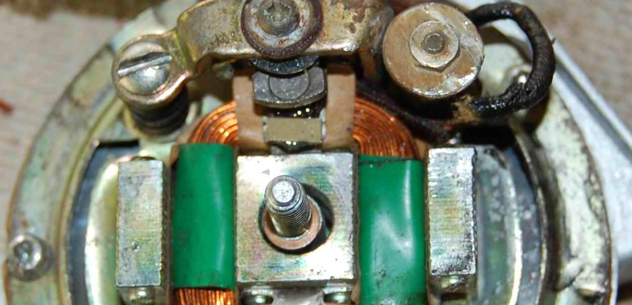

I was thinking more about doing it than taking a picture of it so I used a strip of clear sample credit card to test my theory. Doesn’t show up too good here.

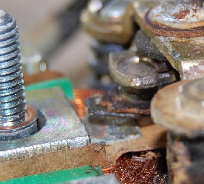

Insulating material worn or rotted away from end of point spring.

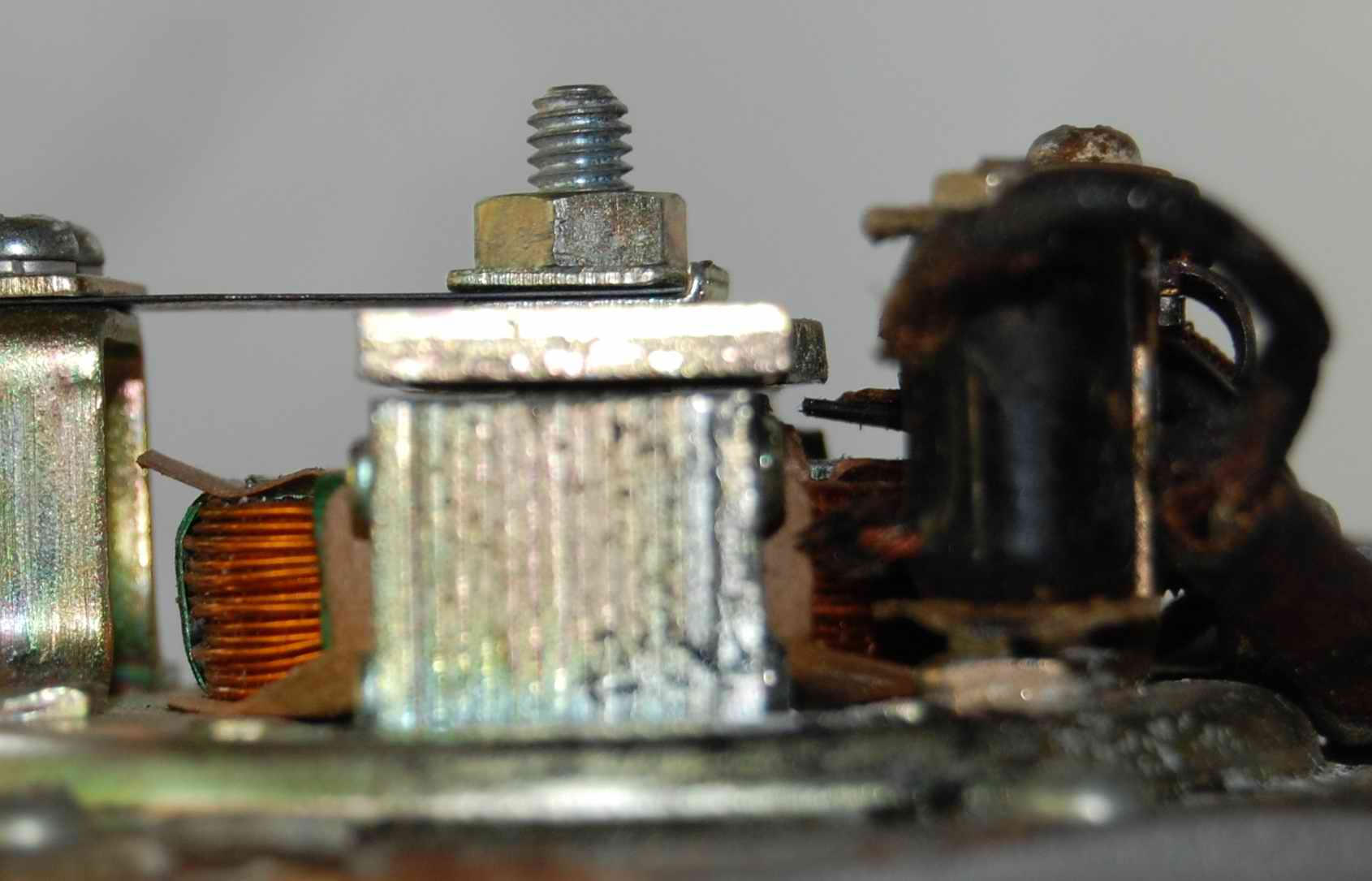

I turned adjuster screw in a ways to emphasize gap between top bar and end of spring.

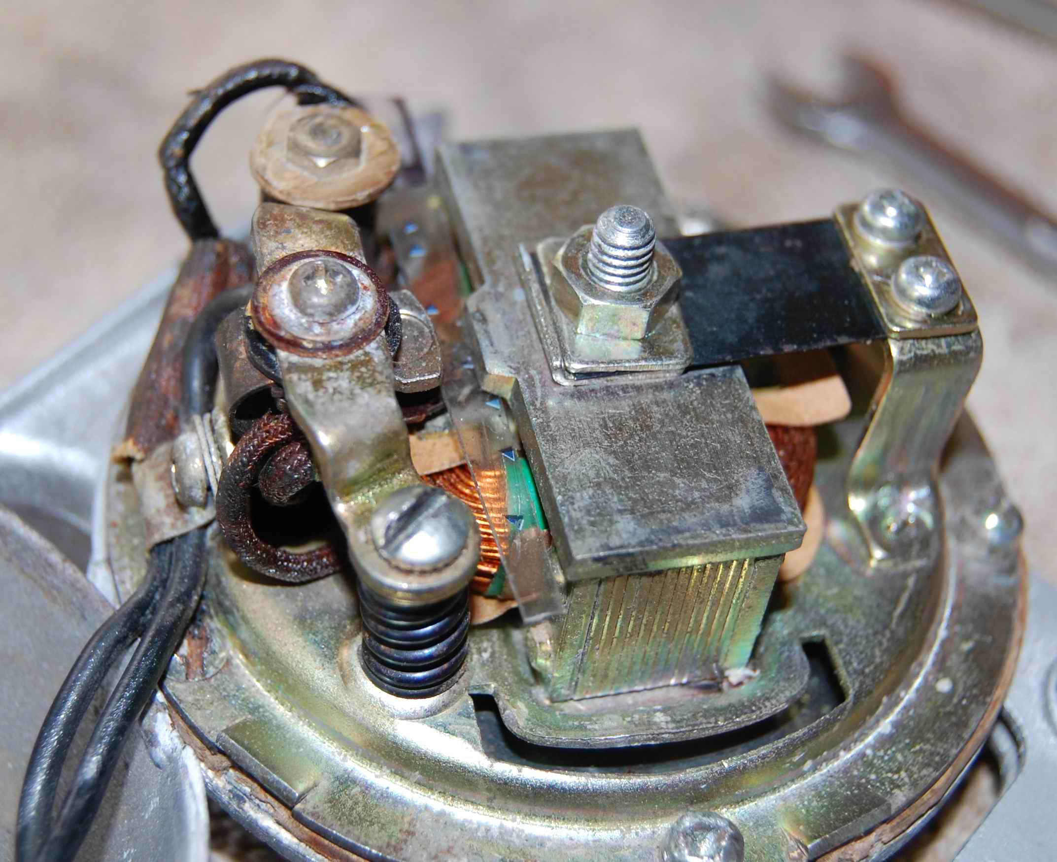

Just to get oriented.
