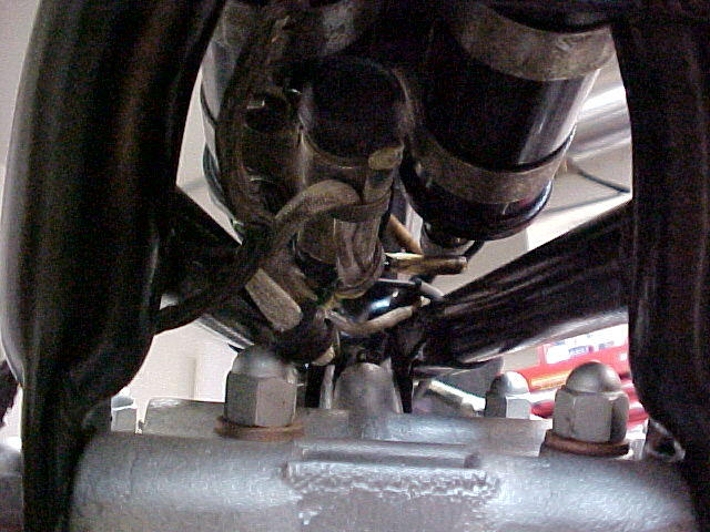

Post by davomoto » Sat May 31, 2008 8:08 pm
Here's a few pics of the coils and condenser that I just installed. On the coils, the black wire goes to positive terminal, yellow and green to negative. Green wire is right coil, yellow left. Ground wire goes from condensor mount to top front engine mount bolt. First one I did was from a box of parts as well, and I spent much time figuring it all out. Hope the pics help!
