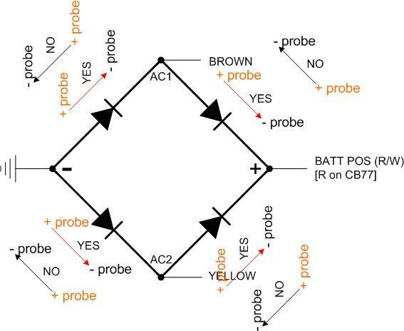

This schematic might be easier to follow at a glance.
Steve
