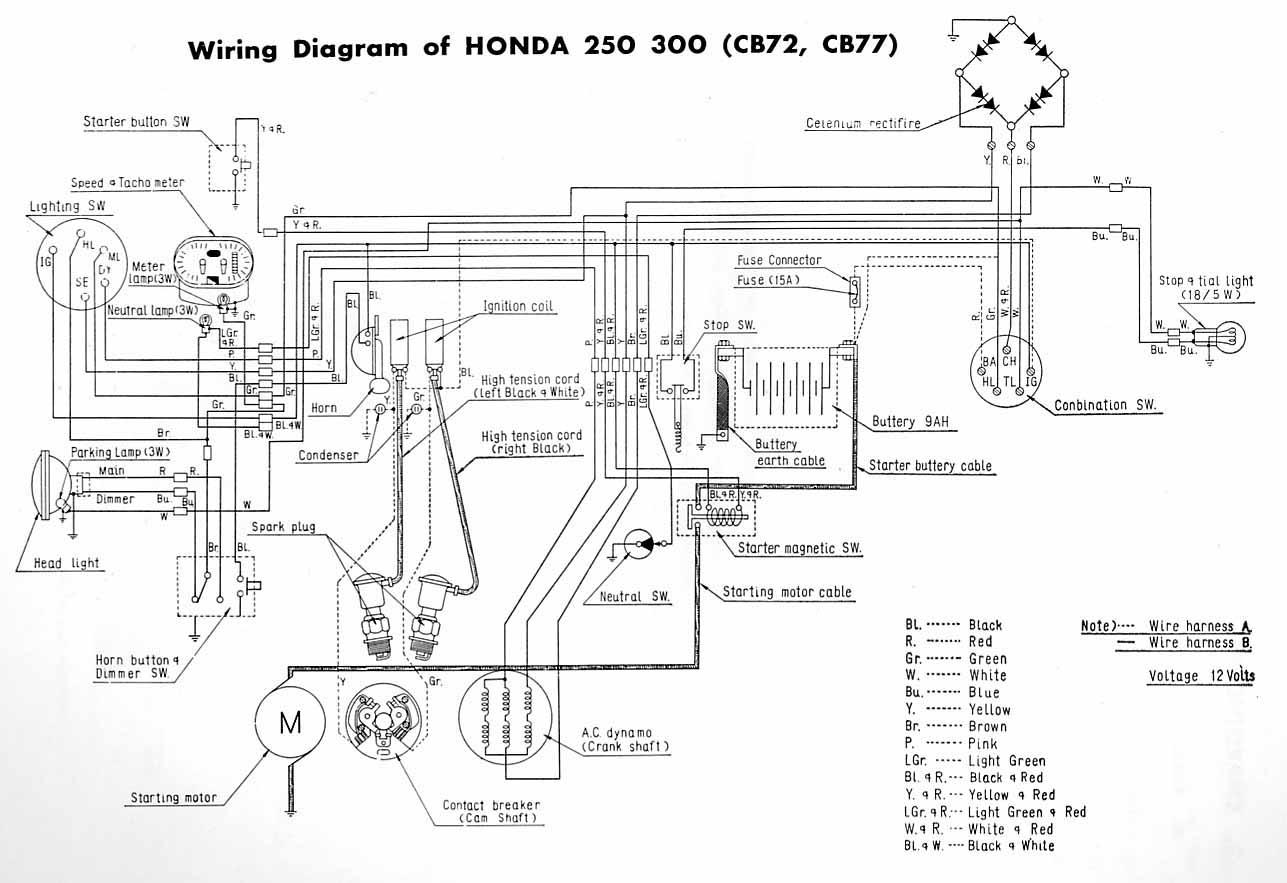

Can anyone point me in a direction to start? Looking at an old wiring diagram, it appears that the power runs from the battery to the ignition switch, could I have a ground in there?

Ignition switch wiring & terminals should be as follows:
Term BA, battery, red
Term HL, headlamp switch, green
Term TL, parking lights, white
Term IG, (ignition system) & key-on circuit, (unspecified) & light green/red
Term CH, charging from rectifier (celenium diode pack) white/red
4. start at the ignition switch, disconnecting the 15A fused feed first - just take out the fuse
Lamp still bright? Put the fuse back in and disconnect the wires from the ignition switch terminals one at a time; if the test-lamp goes out on one of them, that's the problem circuit.

Just re-read your original post, John. You don't say if it's a C(A) or CB(P/YP); their wiring differs. If it's a Dream (C or CA) then this problem could be the rectifier short circuited, as that's connected directly to the batt pos post; if it's a Superhawk (CB, CP or CYP), the rectifier isn't in cct until the ign is on, so my original method of diagnosis still stands.
