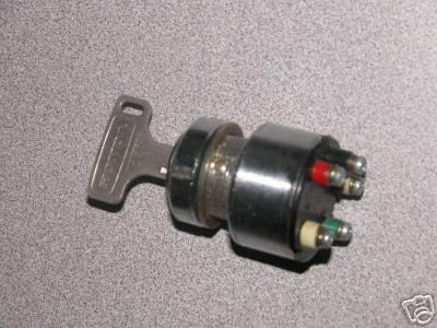

This switch is intended for an early 1970s Honda Dream 305. I am curious if it will be fully functional on my 1966 CB77.
Re: Will this ignition switch work on my 1966 CB77?
Post by LOUD MOUSE » Mon Mar 12, 2007 7:08 pm
NOPE!. ..........lm
Cameron wrote:This switch is intended for an early 1970s Honda Dream 305. I am curious if it will be fully functional on my 1966 CB77.

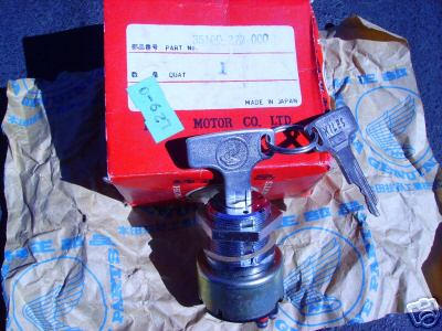

how about this one????
Post by Cameron » Tue Mar 13, 2007 12:54 am
I had heard that early CL72 scrambler ignition switches would work for my CB77...however this is a CL77 scrambler ignition switch. Will this function on my superhawk?
Re: how about this one????
Post by LOUD MOUSE » Tue Mar 13, 2007 3:30 am
273 is a parts number assigned first to the CL72 bike.
As time went on and the CL77 was issued the 273 parts were used on them were possible.
This is for the CL72 and some early CL77 bikes.
Yes it will work and you will meed the threaded chrome part to hold it in place and center the air filter cover. ..................lm
Cameron wrote:I had heard that early CL72 scrambler ignition switches would work for my CB77...however this is a CL77 scrambler ignition switch. Will this function on my superhawk?

Post by Cameron » Tue Mar 13, 2007 1:49 pm
thanks. this helps a lot.
