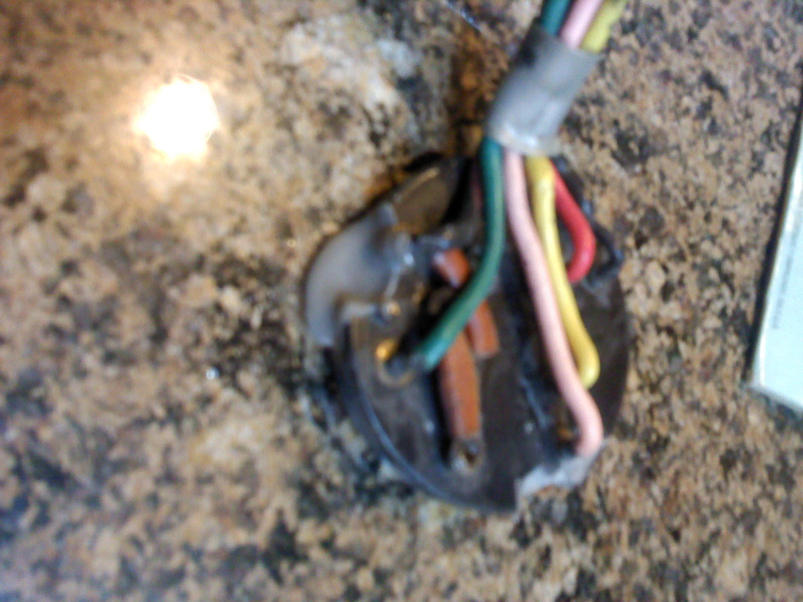

Unfortunately my pics didn't turn out too well. They were kind of an after thought. The first one is the finished product after carefully taking a file to the JB Weld. Mine was broken out pretty badly so the JB Weld had a good bit of area to fill and I think ended up stronger as a result. If your bakelite is only cracked, I am not sure how this will work. You might be able to pile JB Weld on the wire side of the bakelite plate to hold eveything together.

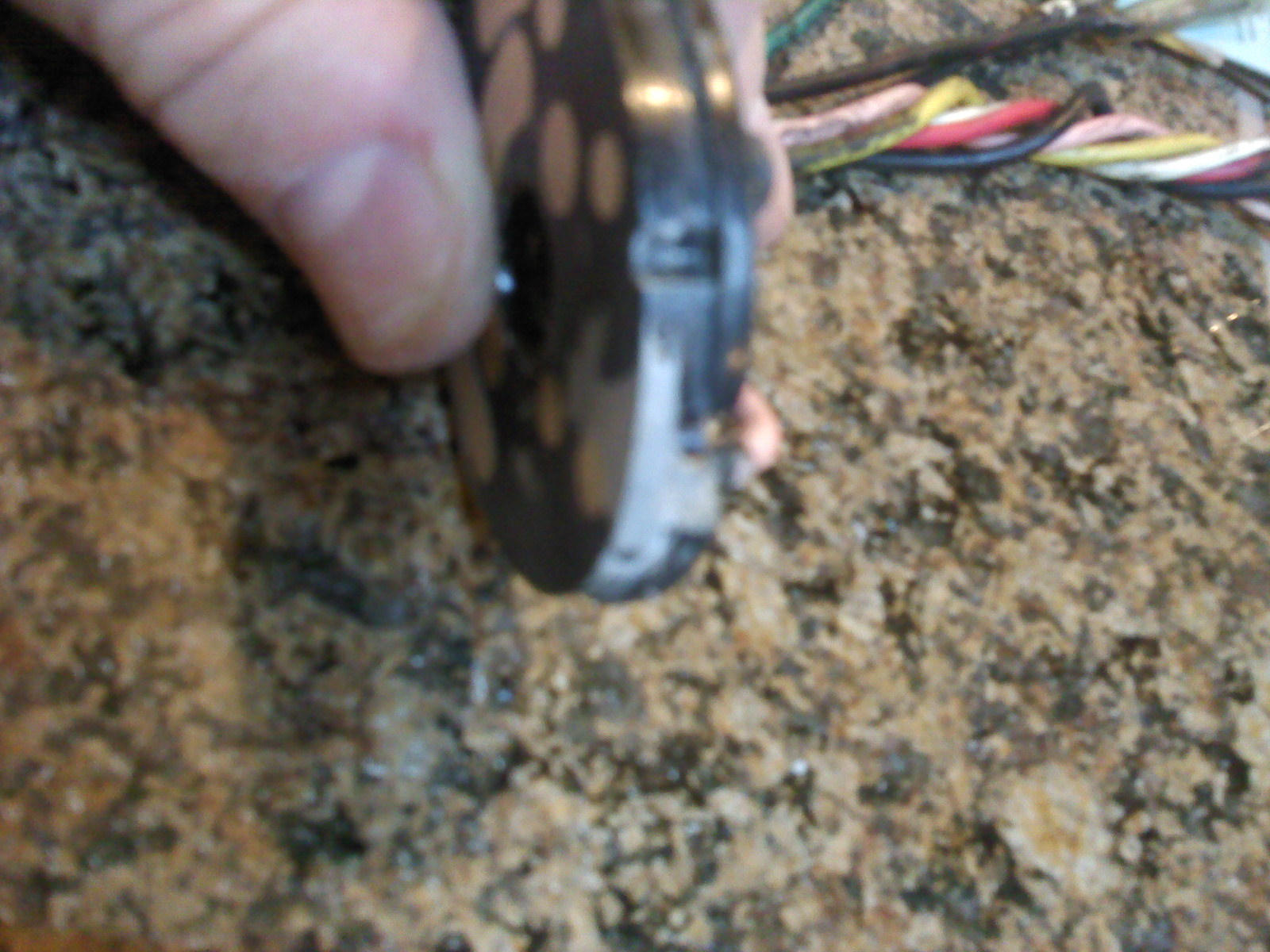

The second photo shows the result after I put the JB Weld into the repair area. I used a tooth pick to mix the 2 components and then used it to apply the JB Weld. Read the instructions. You should let it sit for 15 minutes before putting it on. I then put the bakelight on a piece of paper with the contact side down (like the second picture), prop it up so the bakelight plate lays flat against the surface below it and let the JB Weld set up overnight.
I then put a piece of sandpaper on a very smooth granite surface (not the kitchen counter in the picture) and smoothed the contact side to remove the excess JB Weld. This creates a nice smooth surface for the trianlgle contacts to run on and cleans the contact areas as well. Finally, per the first picture I took a file to the perimeter to round off the JB Weld so the bakelite plate would fit down in the switch housing.
I should have thought to take more pictures, but I wasn't sure the operation would be a success. The patient seems to have recovered fully is now living a normal life in Dream Land.
