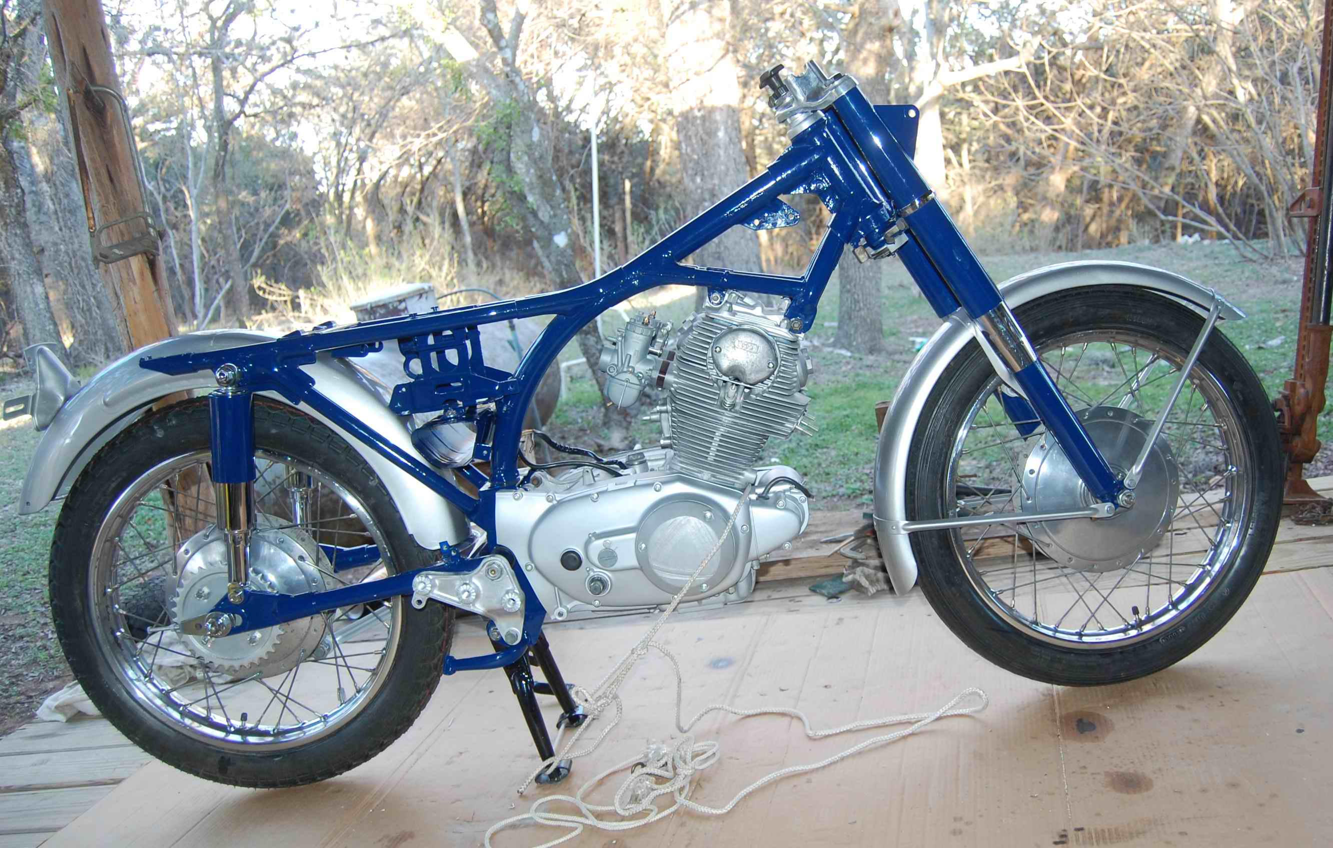

Post by jleewebb » Tue Mar 03, 2009 7:15 pm
Honda's method apparently was to use lock washers with no washers and just let em dig in.
My new paint's kind of fragile still so I'm using lots more washers than Mr. Honda did. Probably overdoing it but I know it's grounded for sure, one less thing to keep me awake at night.
Thanks for your support -- Lee
Here's where I'm at end of today. Having a great time.
