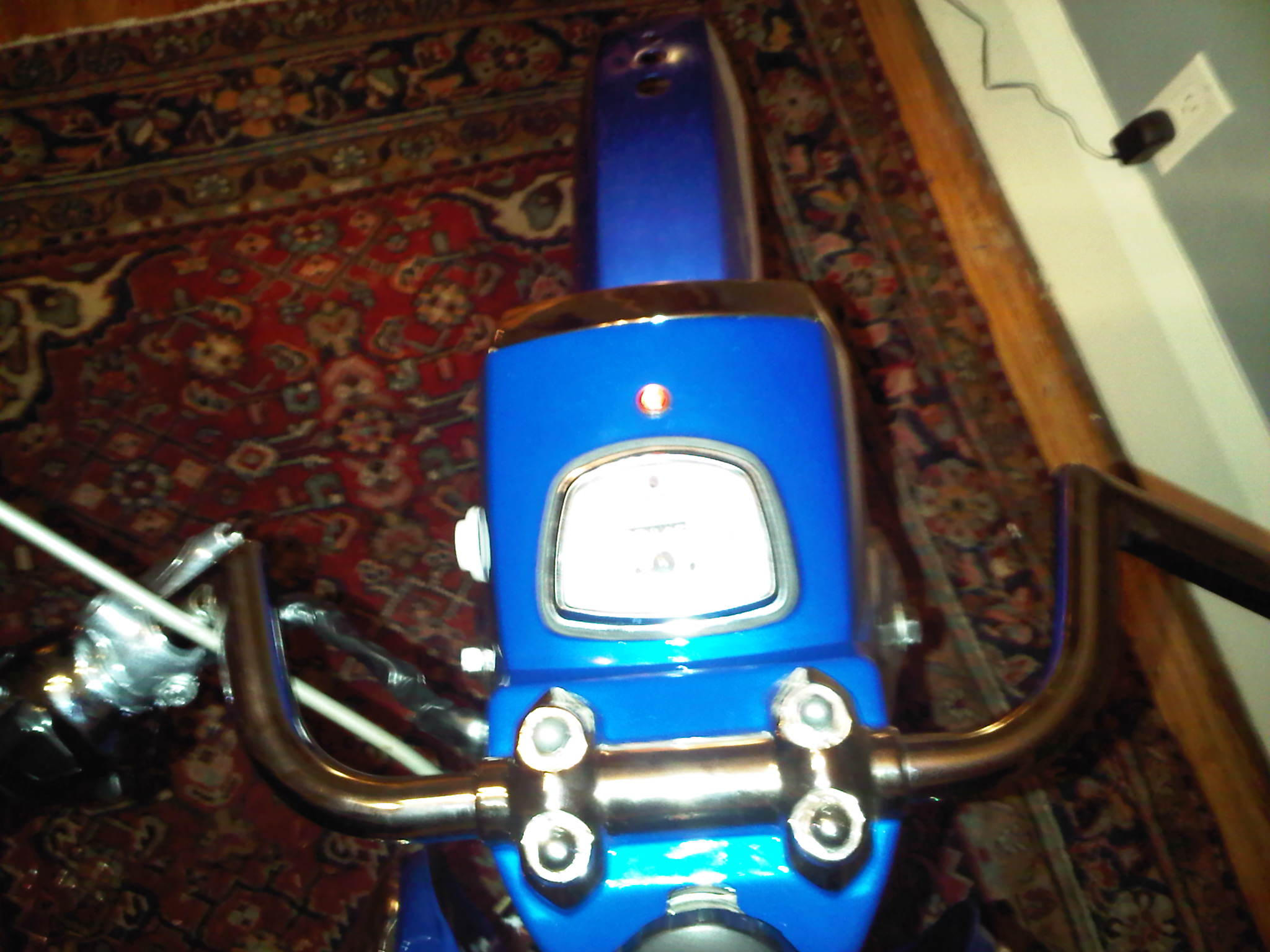

Haha, thanks guys... Aparently what I lack in looks I make up for in smarts though... I got the whole bike wired up and it all works great! One smmmalll question... Whats the green cable coming out of the speedo for? Is it for that little red light in the speedo? I am confused as to why that red light doesnt light up. Let me know and your help/concern was appreciated... nothing that a bit of trial and error couldnt fix! ;)
Guys - Im going to need your assistance knowing what the heck this little green wire is on the speedo for sure, I spend another 10 minutes with it and I cant figure it out, its not in the diagrams.
-Sascha
-Sascha
The little red light should be the high beam indicator...I don't think it shows on the wiring diagram.
It should connect to the same hot wire for the high beam.
The green wire might be a grounding wire...not sure...what does it connect to...the middle post of the lamp or the side of the lamp socket?
