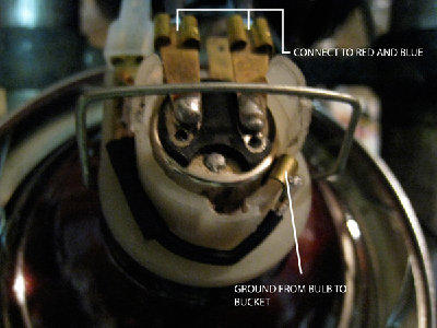

top picture shows a spring loaded wire that shorts out the high and low leads of the bulb?? or at least is appears that way?? Is the bail wire actually touching the back of the bulb contracts and shorting them out?? good luck.. Bill

thanks ill ground it. the headlight is not really working at normal brightness until i rev up the motor otherwise the headlight and tailight flickers in tune with the idle of the motor.

sotxbill wrote:top picture shows a spring loaded wire that shorts out the high and low leads of the bulb?? or at least is appears that way?? Is the bail wire actually touching the back of the bulb contracts and shorting them out?? good luck.. Bill
I missed those pics in Deez's January post; they didn't manifest themselves whilst browsing (it happens sometimes). This isn't right and would cause hi- and lo-beams together!

that diagram i drew of the headlight setup is actually wrong i have one wire going to red then the other wire going to blue and when i toggle the hi lo bar switch it does change from high and low.
