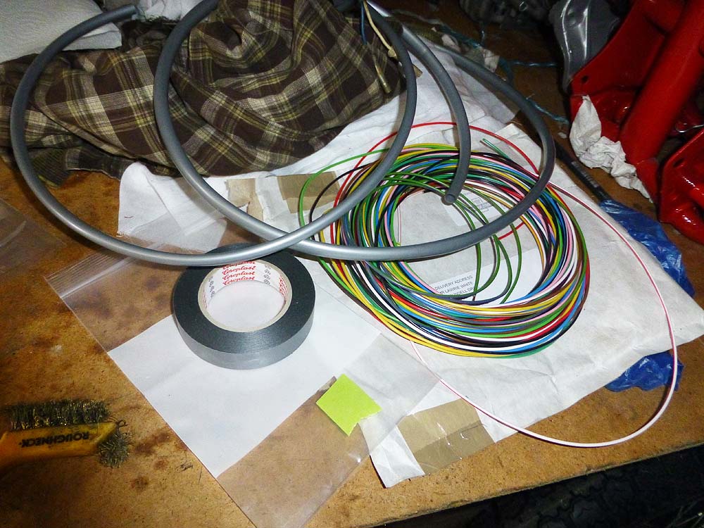

I used the above supplier for the correct silver sheathing AND silver pvc tape when I made a complete replacement loom, its good stuff & it turned out ok.
- pic85.jpg (159.42 KiB) Viewed 3374 times
- pic86.jpg (47.75 KiB) Viewed 3374 times
