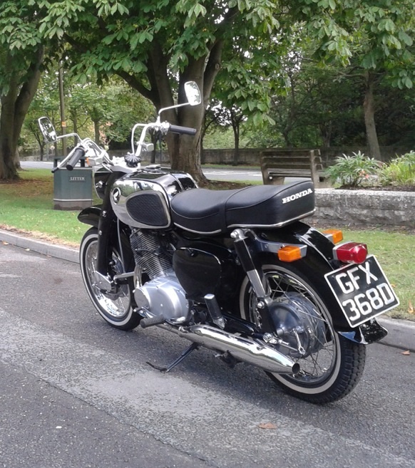

Post by casamere » Mon Nov 30, 2015 2:57 pm
My CA77 with winkers that I fitted as I wanted it UK spec with correct handlebar switch from e bay but not cheap.
