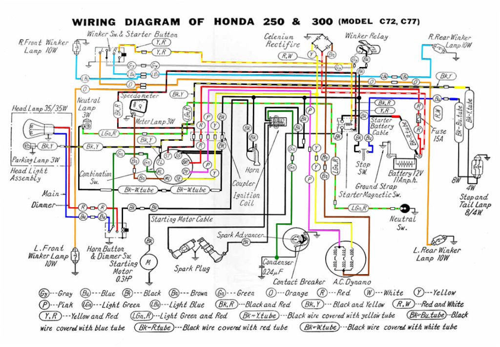

C/CA wiring diagram in colour....
- h305 Moderator
- Posts: 2601
...for my Dream/Touring buddies. Sorry it took a while!
EDIT for the technophobes: left click once on the attached pic, rt click on the image that opens, choose "Save image as..." and save it to your Desktop or My Documents or My Pictures (as long as you're not unfortunate enough to be running that bloody awful, nasty Windows Vista, Service Pack Who-Gives-A-Toss, in which case save the image to Desktop and decide later to where you'd prefer to cut & paste it); opening the attachment first will ensure that you get the best resolution possible from the 153KB .jpg that I was forced to upload.
If anyone wants the original overdrawn file in MS Office Visio, or a PDF, please let me know, e3steve@msn.com.
Also, if anyone wants an A3 print, same applies. I'll post them out, no charge. I can do the CB diag in A3 too.
- C CA 72 77 Wiring diag in colour.jpg (143.98 KiB) Viewed 3102 times

more excellence
Another candidate for the "definitive answers to common questions" section. Great work, Steve.

CB wiring in colour
Thanks Lee. It's part of the OCD that won't allow me to let things go! Here's the CB diag again, just to keep them together here.
I keep a folder called 'Bike' on my desktop, and create subfolders therein with copied/pasted text (in Notepad .txt format) and images, relevant to subject matter.
EDIT: diagram updated with modern colour annotations.
