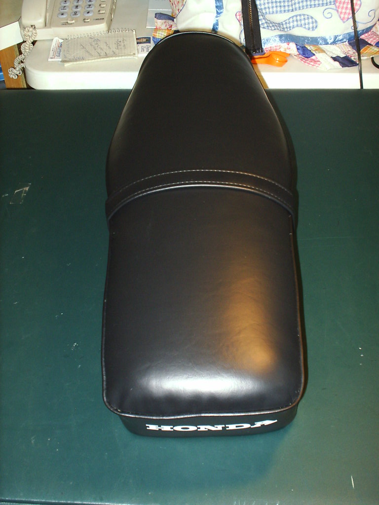

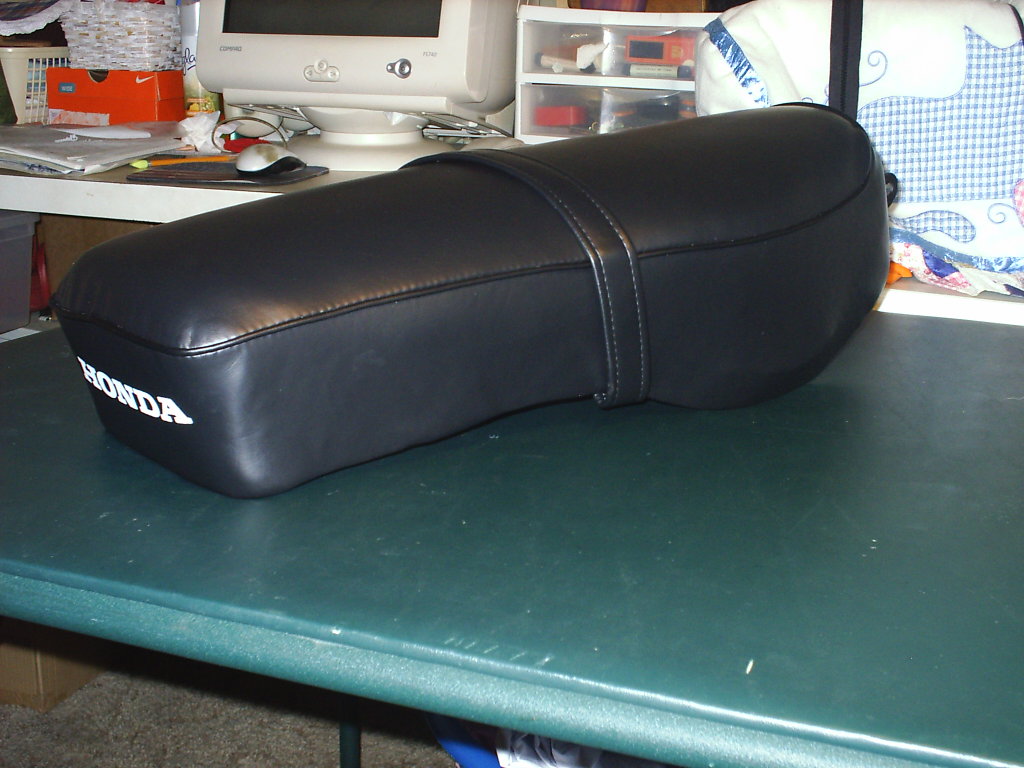

by ironangel » Wed Dec 28, 2011 3:29 pm
Rec'd and installed seat cover from siriusconinc.com, they are listed for 63-69 dreams. as you can see by the pictures,they will fit early 61-62 seats. my foam was in pretty bad shape as are the prongs that hold the cover in place. with a little doctoring I think it turned out fairly well...jk

by bbap » Wed Dec 28, 2011 7:10 pm
Looks good! :)
I used them for my '63 and was quite pleased with their price, service and speed. Steve
