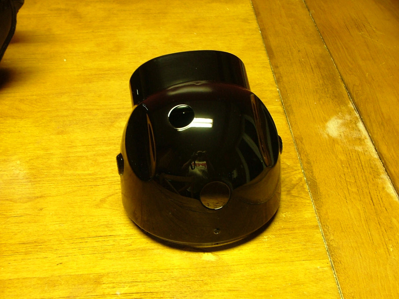

Personally I pretty much suck at it. I can't take credit for this work . But thankfully my brother saved me on this one.If I were to paint it half would be orange peel and the other would have a sag in it the size of the Grand Canyon. To all you painters out there. Cheers!!
K36 self etching primer and seal coat, PPG GM Black base , 2 coats clear .
Tank
Tank
Headlight bucket
Headlight bucket
64' CB77
65' CB160
