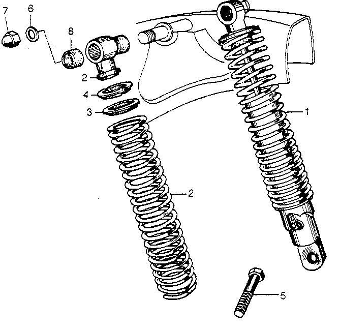

I just checked the fische on the CB92 and it looks like the shocks were eye and clevis.
I think it was a look-alike build. Have any more pictures of the front end? A CB92 wouldnt have tapped holes in the lower part of the fork for the chrome covers.
