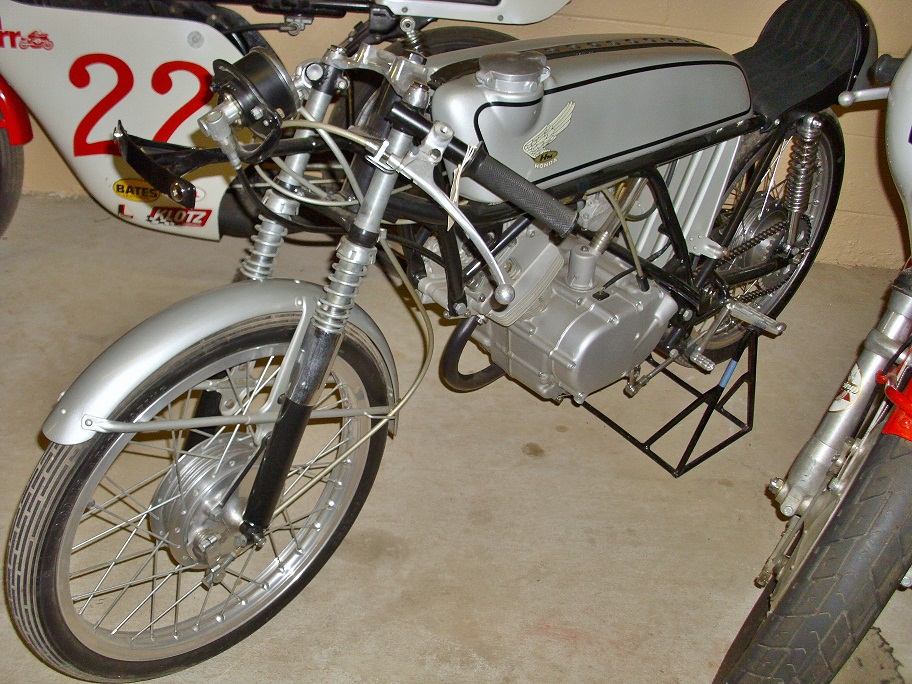

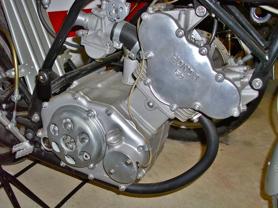

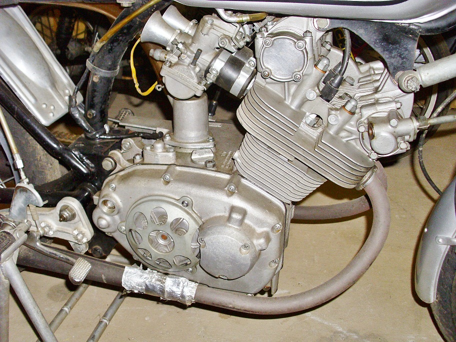

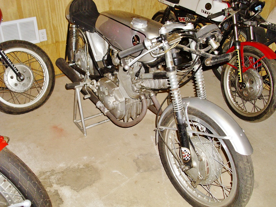

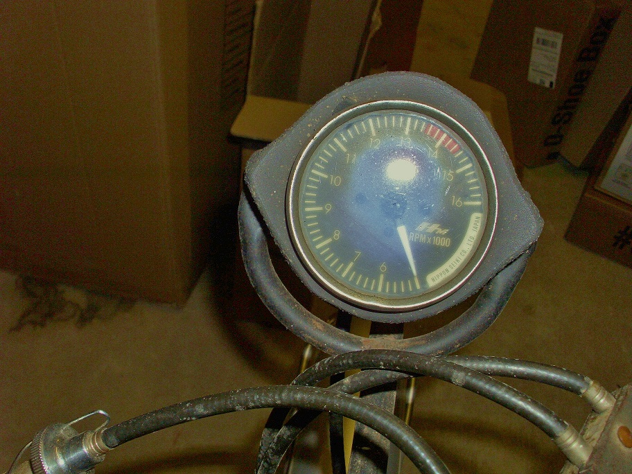

Stumbled on these while scrounging parts recently, thought you all might find them interesting.
Not 250/305 based but pretty nice none the less.
