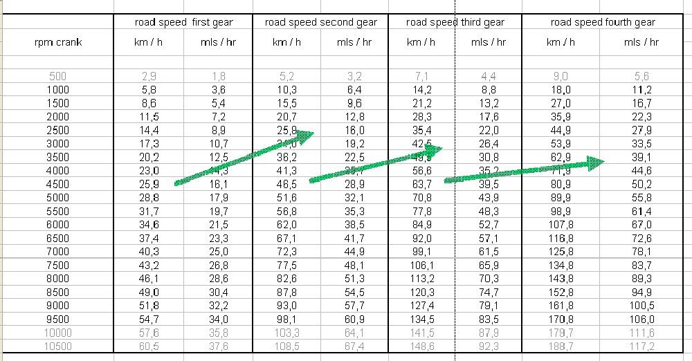

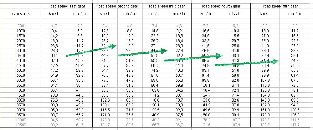

Just came back from the road testing, and I think we're done. Unlike the last time, with temperatures in the 40's, today was in the low 70's, and I'm sure played a role in the final jetting numbers.
We ended up with 240 mains, and lowered the needles to the middle position, and it runs smooth as silk. I could redline it in every gear except 5th (2nd gear at redline was almost 60mph). As well, we had the 32 rear sprocket on there, and I think we're going to put the 30 on instead and be done with it.
The bike now seems to ride like a 550, though John told me that it sounded more like his 750 Triumph as I tore out of his place on one of the runs.
The top speed actually dropped to about 95mph from the 105mph on the colder day, so this is probably about as good as we're going to get. Doesn't really matter too much, as I normally never ride at that kind of speed.
So besides putting the 30 tooth rear sprocket on, the only things left to do is the powder coating, and putting the new tank back on. Hopefully all that should be done by the end of next week.
