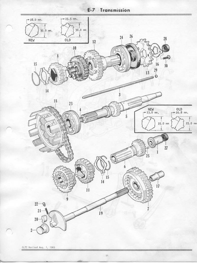

Good points, and that will definitely be looked at, but I wanted the 5 speed anyways, and the kickstart shaft was peripheral to my decision. As far as what has been failing in the existing transmission, it is the kickstart shaft that is wearing, and eventually starts to move on its own (only in 2nd gear at low speed). This is the second time it's done it, and probably because I've put so many miles on the bike, not to mention the inherent design of that shaft.

The design of this gearbox means that the kickstart shaft passes through and supports the mainshaft via loose rollers running on the kickstart shaft. As the kickstart shaft wears, friction increases which causes the kickstart to rotate while the bike is being ridden.
The 5 speed replacements use a solid layshaft so this problem (and the kickstart :-) ) is eliminated.
