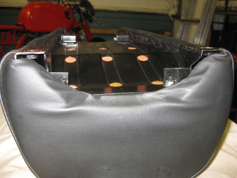

HELLO EVERYONE

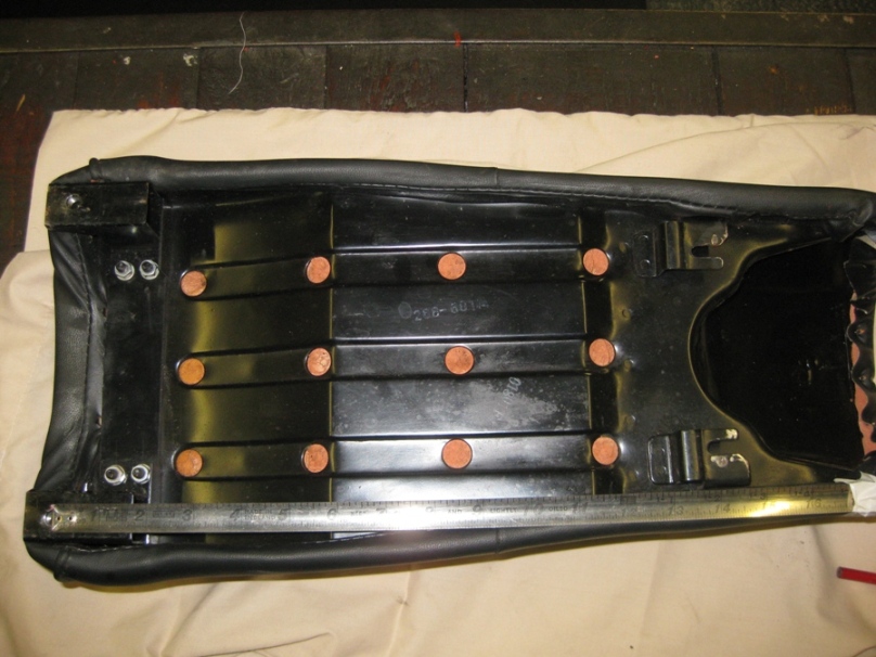

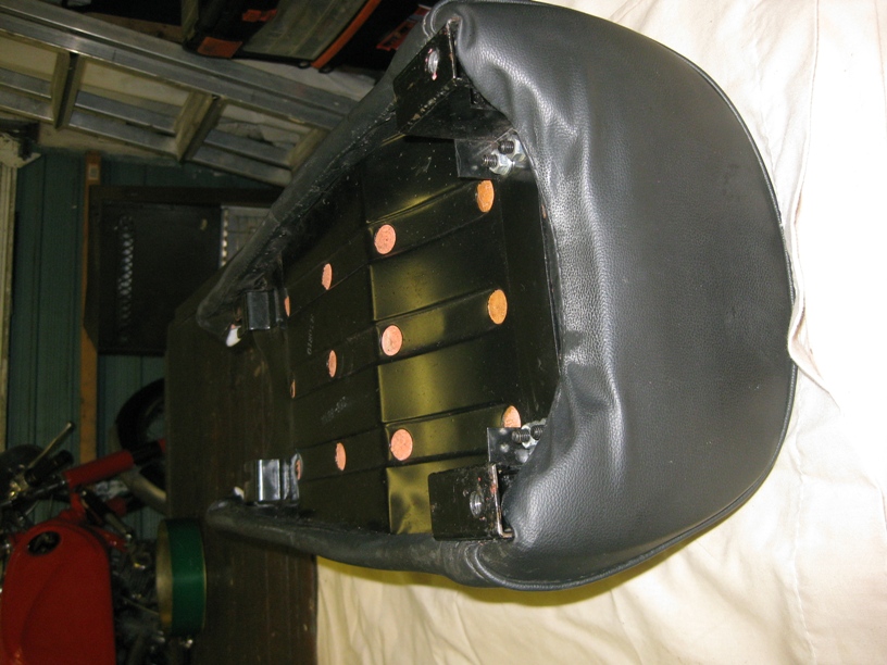

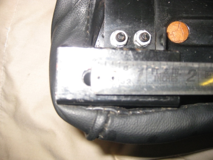

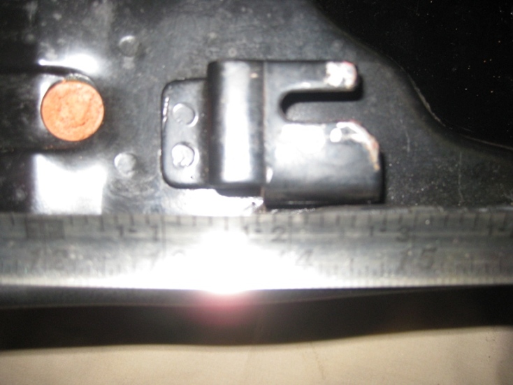

HOPEFULLY ATTACHED ARE SOME PICTURES OF MY RACE SEAT WITH A MEASURE, I THINK CLIFF IS CORRECT THE END EXTENSIONS SEEM TO BE THE ONLY DIFFRENCE ON THE LATER MACHINES.
MY SEAT IS ARROUND 14 INCHES BETWEEN THE REAR BOLT LOCATION AND THE FRONT PEG SLOT.
I HOPE THIS IS OF SOME USE AND THE PROJECT IS GOING WELL.
GORDON
SAFOJ
GORDON

Thanks for the pics Gordon.  Those clear up a good bit on the fitment.  Looks like all the modification for the new ones was only in the bracket.  From the looks of your bracket, Honda flared it back an inch while keeping the original mounting location and did not change the seat length at all.
I went ahead and updated my molding guy to keep the seat the same length. Now I just have to give my machinist a revised bracket design.

Hello

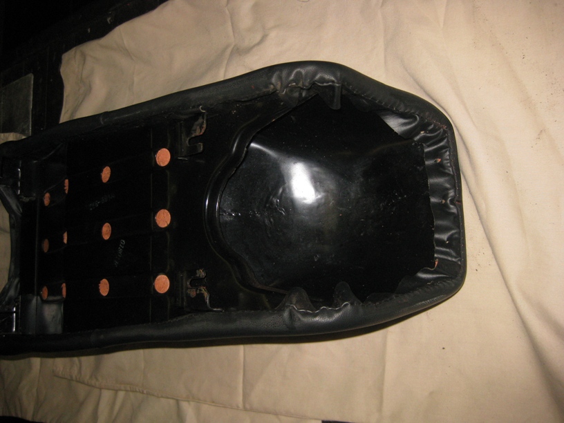

It seems right about the extentions, you can see where they are set back, I have put the seat back on the bike but its easy to remove iit if you need photos of a specfic area.
I am posting, hopefully the other photo's I have taken.
Gordon
SAFOJ
Gordon
