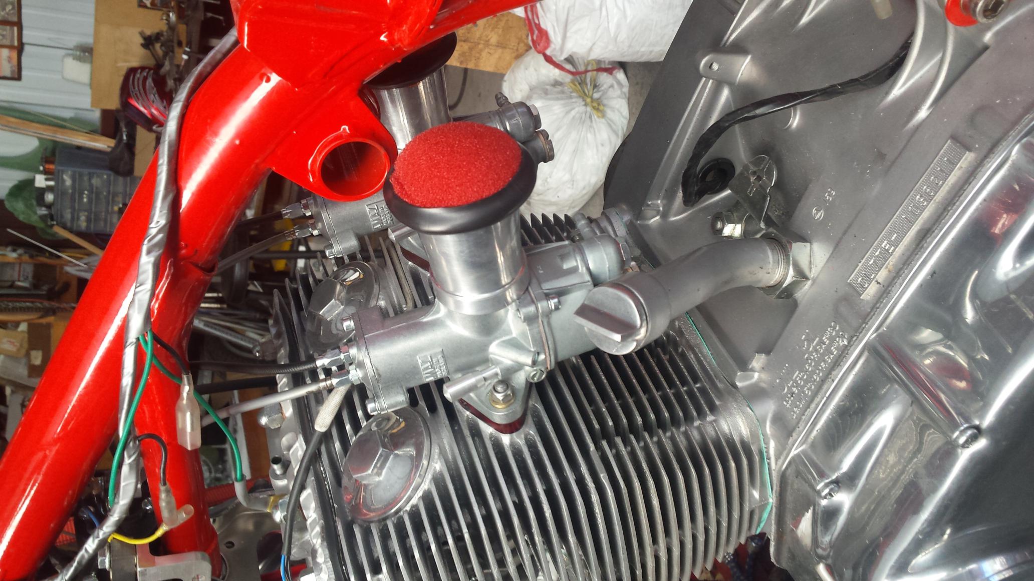

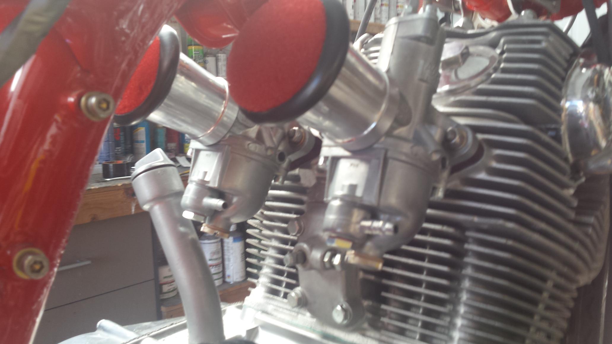

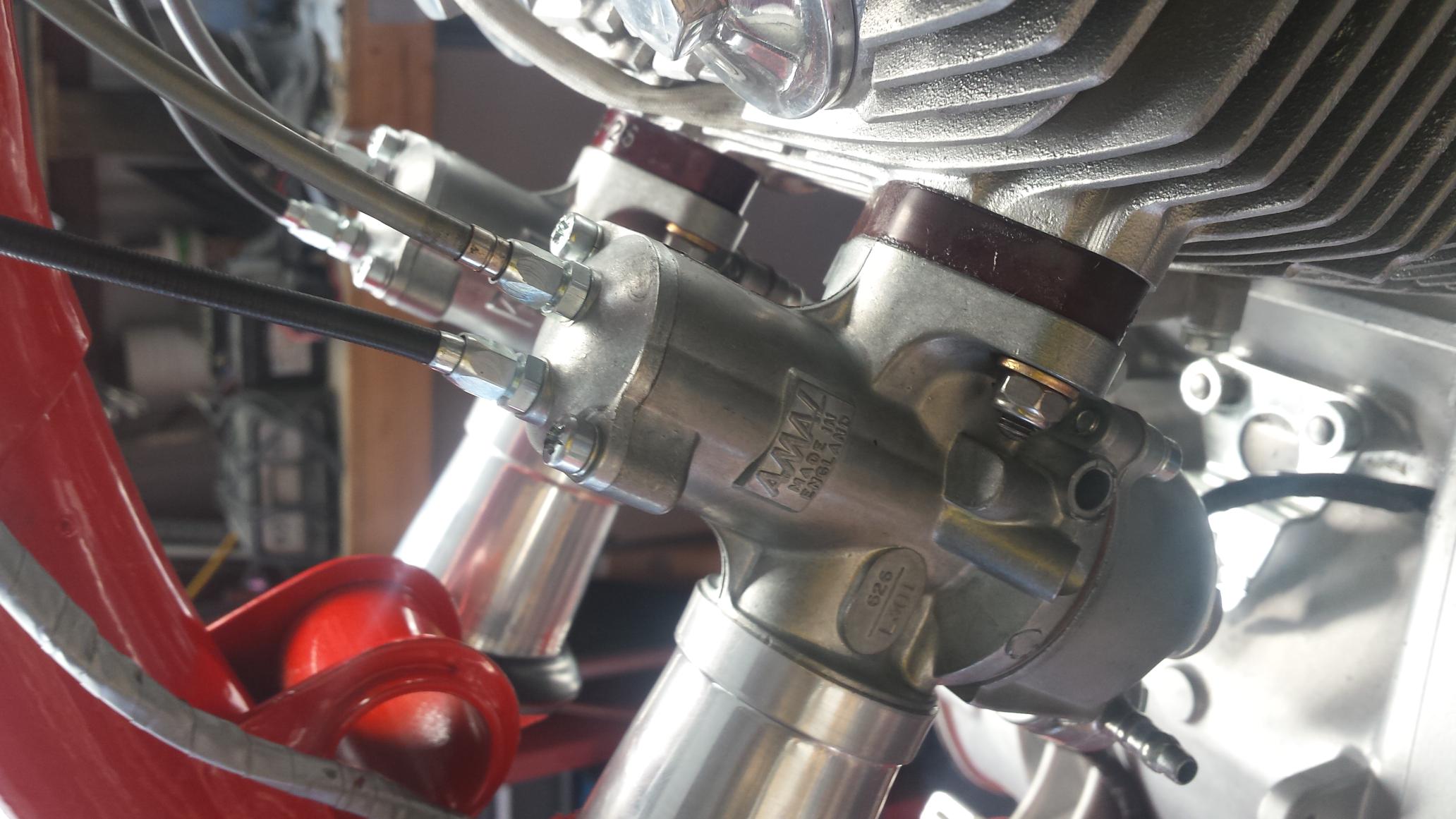

The Heim joints are std thread. The carbs are Amal 626-301 w/ chokes and used the std Honda throttle cable and splitter.
Amal 626-301 w/chokes

It appears your chokes are cable operated, and you used a second oem throttle cable for operation? Choke lever set-up?
How close was the jetting on the Amals, as purchased?

You can see the choke lever on the left side of the handlebars. The OEM split cables for the carburetors are short by about an 1/8", not letting the slides seat on the adjustment screws so we are having a pair made.
The carburetors came stock with #2.5 slides 160 main jet and 106 needle jet, running too rich, we bought a # 3.5 slide which leaned out the mixture, when the inclement weather clears we'll do more road testing.
