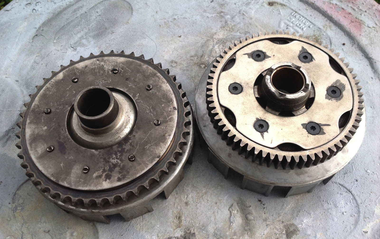

I acquired a CR72 primary cover a while back to look at how it was done by Honda back in the day. This one came up on UK eBay, rather surprisingly. It won't fit a CB72 engine but is very interesting.....
The other pictures of a gear primary conversion using a CB500 clutch drum with gear and the idler gear (actually a gear from a Honda gearbox) with mounting plate.
				- 002 Clutch compared.jpg (188.17 KiB) Viewed 9499 times
				- 001 Idler Gear.jpg (202.25 KiB) Viewed 9504 times
				- CR72 Clutch 1.jpg (179.62 KiB) Viewed 9507 times
