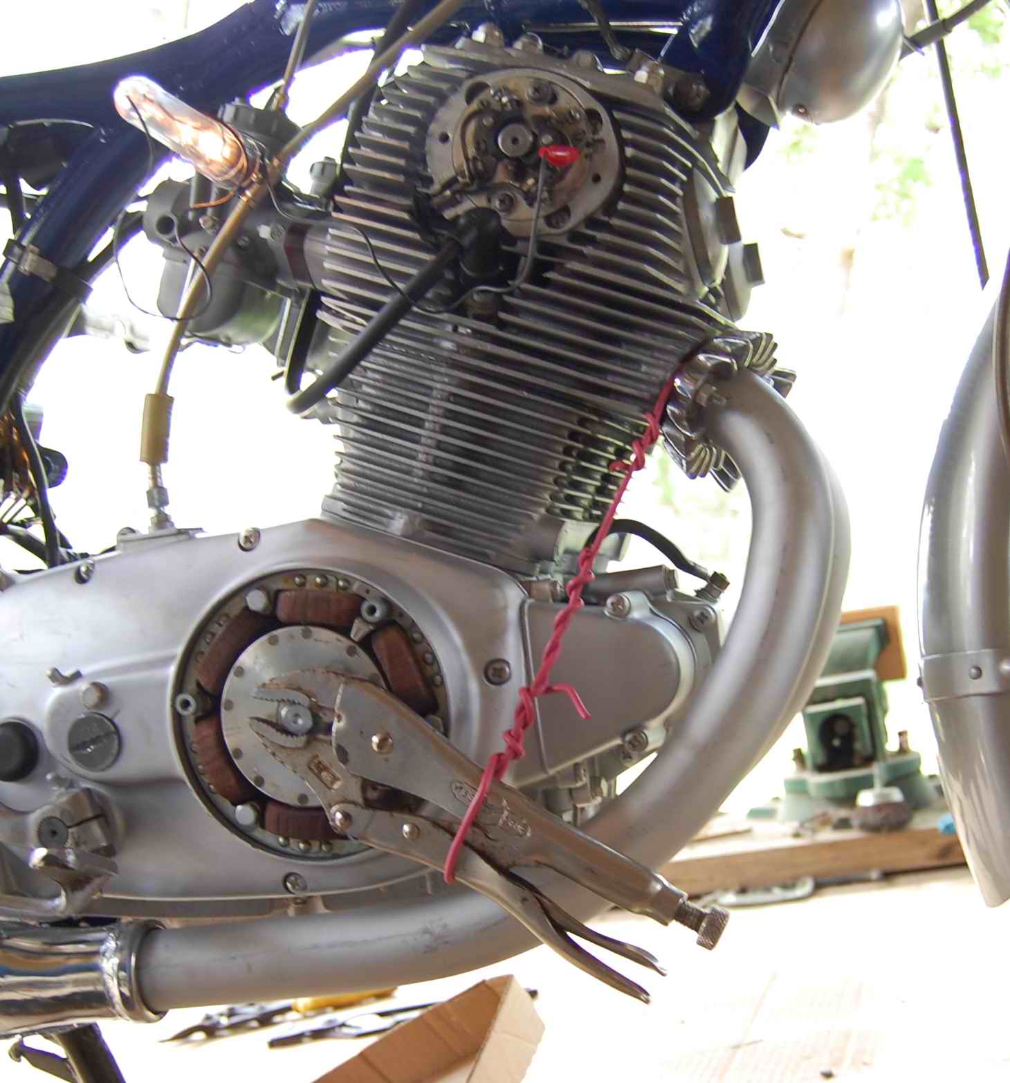

If that doesn't work, go to yellow sidebar on left (at least in my browser) to FAQ, then "how do I tune my CB77 for maximum performance." follow directions exactly. good luck, Lee
