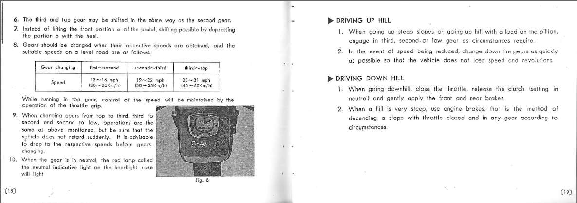

This is an extract from the manual which can be found on this site.....
http://www.mediafire.com/?jddnnx5qvs3np0x

According to the manual linked to here (THANKS!!) you shift into top gear at 31MPH. I've tended to rev significantly higher than that. I'm a little surprised, since the range for 1st to 3rd is around 10mph per gear, but I would expect to be able to hit at least 70. Where is the power band the best on these engines?
