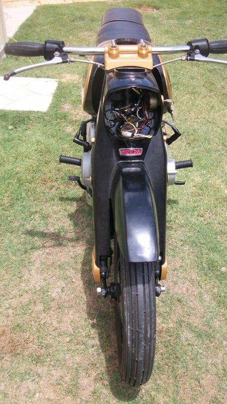

I put low bars on my Dream.
I had been fighting with the slotted throttle tube for a while.
No amount of lube/polishing etc would get me a nice throttle return...it would always "hang"
I finally settled on cb400 bars which had the proper knurling and were drilled properly.
The listing isn't there anymore but the description was: (http://www.ebay.com/itm/HONDA-CB400-CB4 ... HROME-BARS)
Then I stayed patient and continued to watch eBay for a couple weeks and picked up:
CB77 throttle housing
CB77 throttle tube
CB77 throttle cable
and ended up with this:

Post by Muddy » Mon Feb 17, 2020 4:10 pm
That looks great.
