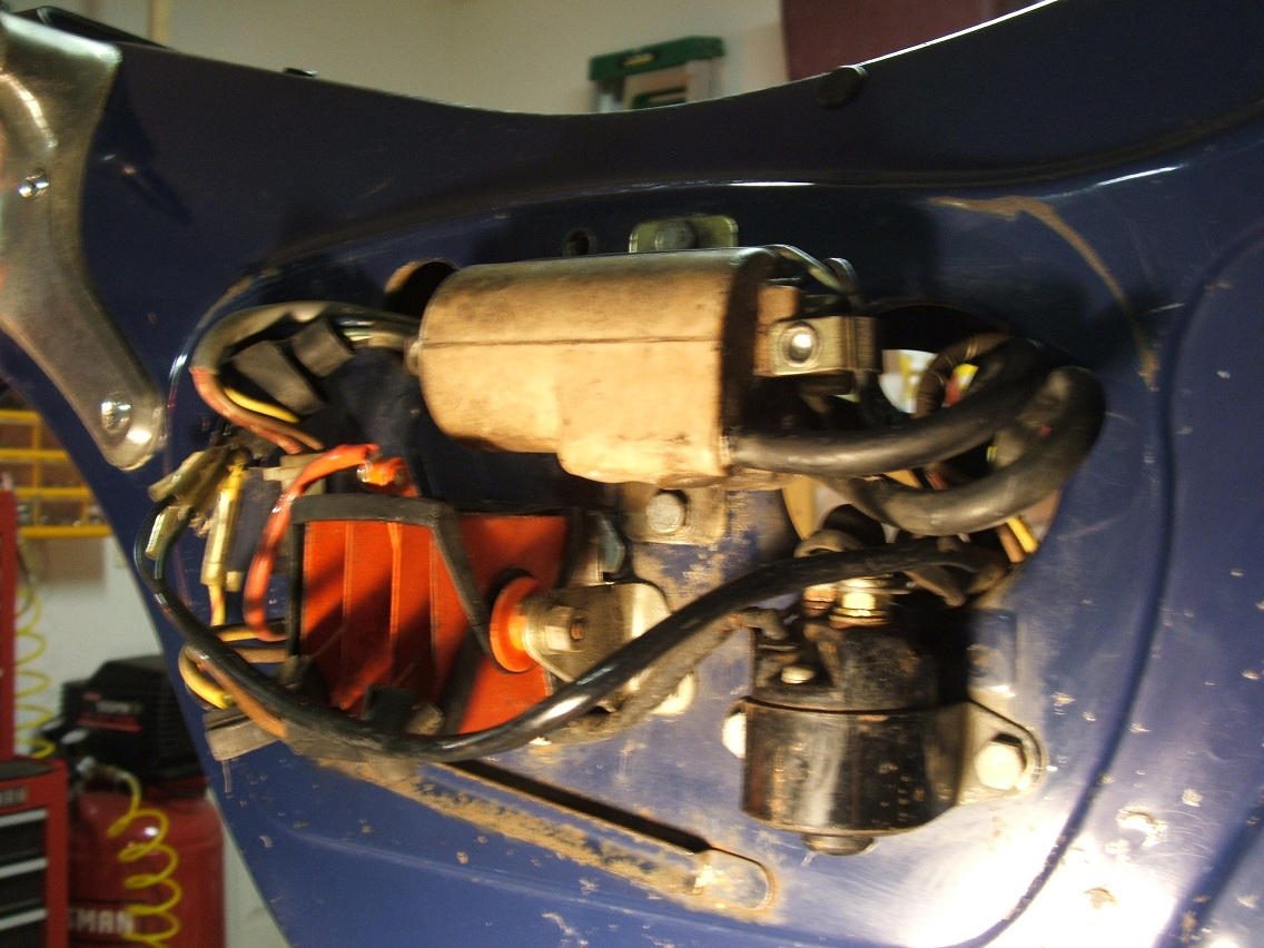

The solenoid IS the switch that closes to energize the starter motor and it sounds like you've ruled out everything else. Rarely, but sometimes, you can tap on the solenoid and if it's only a little sticky inside, it will actuate. If not, just look for one on ebay, a good used one isn't hard to find. Just to be sure we're on the same page, I attached a picture. The solenoid is the black cylindrical unit under the coil.
