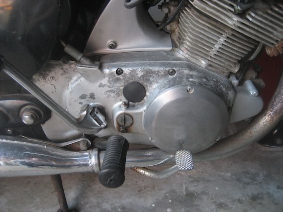

Case
Thanks guys for all your replies!
I did check my book and it does say I should get the 020 part as well.
Here are some pictures!
rrietman, I would like to replace it because of the crack. I'll PM you.
