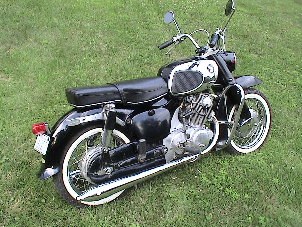

I got the "Apex" style for mine before I read any feedback from the company.
They are 31" long and 3" max diameter (at 27" from the inlet).
I had to tweak one to fit as the welded tabs are not adjustable, and the inlet end is not split for tightening with a clamp.
I do like the shape, however.

A pic of mine:
They are also available from several overseas vendors like this:
http://cgi.ebay.com/ebaymotors/HONDA-C7 ... 53e6e03152
It looks to me like the Dunstall long megaphone style would fit, though I haven't seen them on a Dream myself.
http://www.jcwhitney.com/dunstall-style ... map=16467G
A pic of mine:

I ordered a set of those too, from the vendor you linked to. My advice? Don't go with surface mail. It's cheap, but they take something like 12 weeks. By the time you get them, it's too late to leave feedback. I'm still waiting and it's been almost 8 weeks.brewsky wrote:I got the "Apex" style for mine before I read any feedback from the company.
Brewsky, did you end up splitting them and using a clamp? Are they the right size for the original headers with the stock gasket? I notice that the originals don't have a clamp either.

I got mine from Apex Cycle, a US vendor, but it still took a month or so from them.
If you do a search for them on this site you will find some pretty bad feedback in their customer service department.
If I had to do it over again, I would probably try the Dunstalls......I don't know..
Should clarify that they are not actually "Apex" brand, that is just the name they assumed since Apex seems to be the only US vendor.
