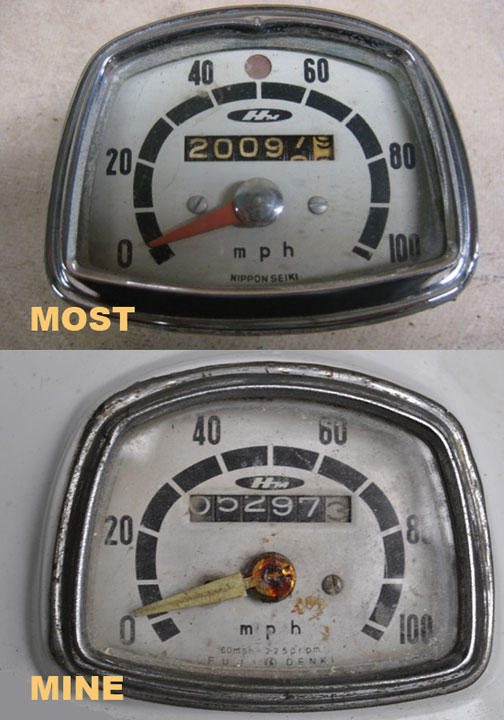

Try as I might I can't seem to answer this basic question. Most Dream speedos I see have an indicator light at 50mph. Mine does not. What is that light and is my speedo incorrect ( maybe from a Benly or ...) My (reprint) owner's manual doesn't mention the speedo light.
Also, it seems that the needle was red, no?
My bike's a '63- don't know if that's relevant here or not.
Thanks all.
Thanks all.

yours is correct i too have a 63 and mine doesnt have the light above the 50 mphhouseowax wrote:Try as I might I can't seem to answer this basic question. Most Dream speedos I see have an indicator light at 50mph. Mine does not. What is that light and is my speedo incorrect ( maybe from a Benly or ...) My (reprint) owner's manual doesn't mention the speedo light.

High beam indicater. .......lm

speedo
OK; here's my survey of what's sitting around in the shop
-1962 yazaki no high beam lite
-1963 fuji denki no high beam lite
- ????? fuji electric orange high beam lite
-????? nippon seiki no high beam lite
-apex repop red high beam lite

Probably yours was a red needle before the UV-attack.houseowax wrote:Also, it seems that the needle was red, no?
