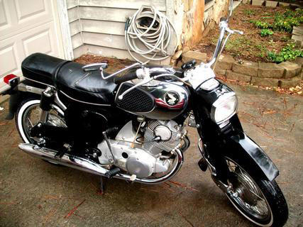

To the best of my knowledge most things on my bike are stock. However could the shortened cable length be caused by aftermarket handle bars? I've attached an image of my dream for reference. I'll have to check around on eBay.
Post by brewsky » Mon Apr 26, 2010 4:03 pm
Looks the same as mine as far as I can tell.
