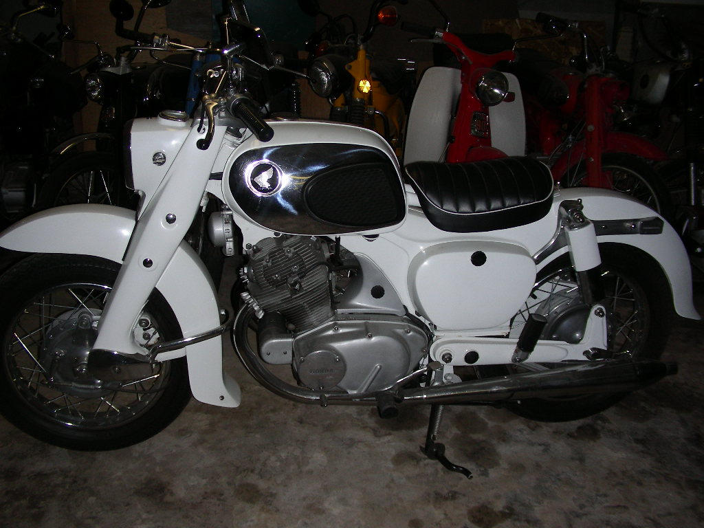

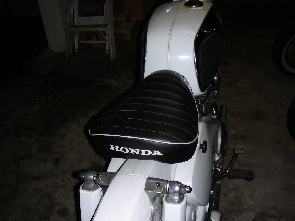

Post by rrietman » Sun Nov 16, 2008 8:23 pm
B; couple pics of the CT90 seat. the front mounts are tubing with one end flattened and cut to look like the stock front mount. the rear mount/pad is pretty self explanatory, there are holes in the frame to bolt to already.
Good luck
Randy

Post by bj » Mon Nov 17, 2008 12:47 pm
That looks great, good work,
Thanks,
