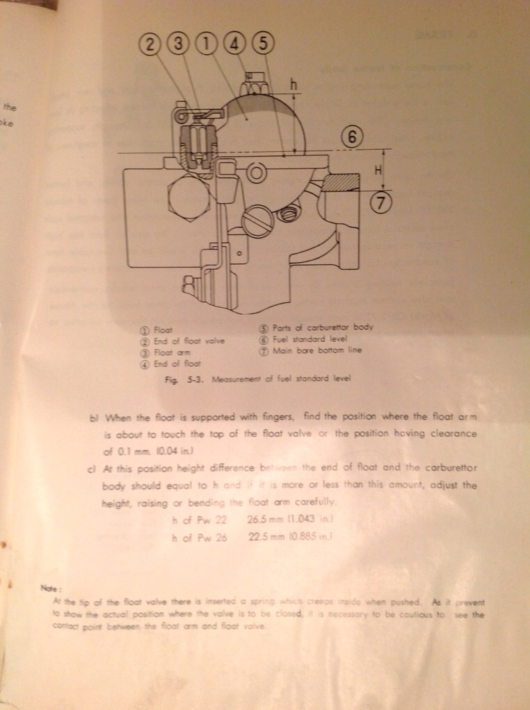

This is what the manual says

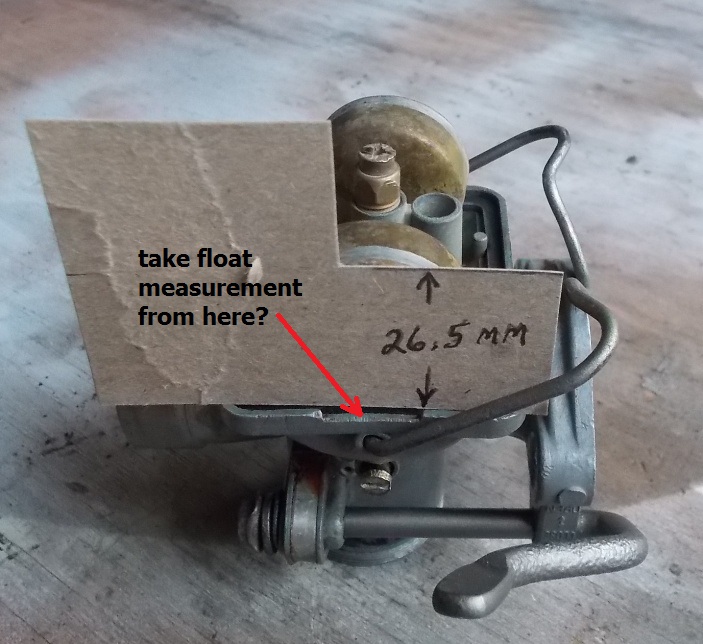

That's all good.
Your tool design is not what HONDA uses.
What carb does this show as this pic doesn't show the CUTOUT at the side and that is where you are to measure yours from.
The HONDA tool is a sort of "Wide "U" and is used right to left OVER the FLOAT.
Not along the SIDE.
That is the reason for the CUTOUT with this carb. ..................lm
casamere wrote:This is what the manual says

LOUD MOUSE wrote:Measure from the Cut Outs. ....................lm
I got my info from Bill Silver, however, I may have misunderstood the diagram. So you are saying I should take my measurement from where the red arrow is showing?
I figured that the original tool would go over the floats because one could be higher or lower. When I originally measured mine, I just checked both sides.
Jim
Post by LOUD MOUSE » Sat Mar 11, 2017 9:36 am
That is the level. .................lm

Post by Jims65CA77 » Sat Mar 11, 2017 9:42 am
THANKS!!! I will set my float level again and make a NOTE of this.
Jim
Post by LOUD MOUSE » Sat Mar 11, 2017 9:53 am
You are welcome JIM.
Not all of these carbs have that level cut in.
Just depends on the engine HONDA installed them on. ...............lm
