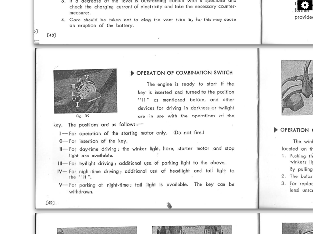

If memory serves me correctly, the switch positions are something like this:
1. Off
2. Prime (power to starter only)
3. Engine on
4. Engine on with lights
5. Tail light only (key can be removed for parking on street)
I don't own a Dream to verify this, so please feel free to correct me if I've got it wrong.

Ok. I guess I had it wrong. According to "Mr. Honda" Bill Silver in this article, the first position is prime and the second position is off. In addition some models had six positions with another one for the lights on without the headlight for twilight riding.

A lurker here as well, but this forum has been a tremendous help to me. So I thought I would try to start paying it back. There a several sites where you can download copies of the owners manual and the maintenance manual. I believe Scrambler cycle has the maintenance manual and I found this with a quick search: http://www.classiccycles.org/1852/1873.html
And if you plan to get into the engine Bill Silvers information is worth the money - also has a lot of good general information.
Hopefully attached is a page of the owners manual with the switch positions explained.

No harm here. I had it wrong at first anyway. Thanks for the attached image, it makes better sense when you have a picture to reference.
