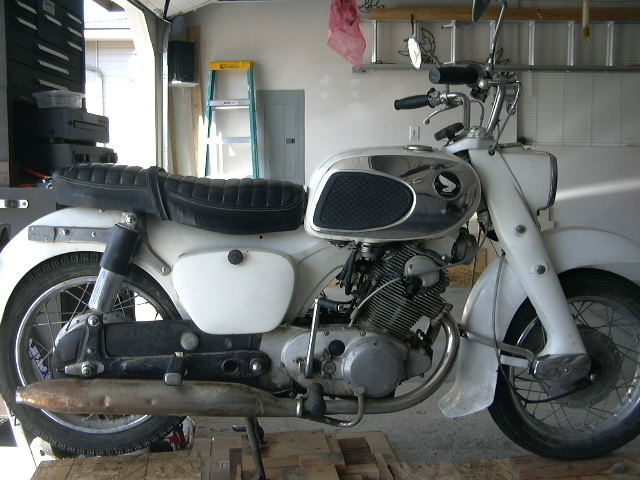

finally got a picture. I have sanded the brake shoes and drums but have not tried them out as I am waiting for a petcock repair kit. Mike1969, there is your footpeg in all its glory, Thanks

I am not going to restore this bike. I am guessing that it was originally white and something bad happened at the rear end. Most of the chrome is pitted but it appears to be a solid bike. I hope to make it a reliable runner.
Post by brewsky » Sat Apr 04, 2015 3:40 am
That should clean up nicely!

Nice Bike
Post by conbs » Tue Apr 14, 2015 8:33 pm
I am with Brewsky. Take some time to clean up that Chrome. I have had good luck with Flitz. Whatever you decide, you can probably make that chrome very shiney.
You should be able to get that paint rejuvenated as well. Start with rubbing compound and take your time. Next, polishing compound with a lot of elbow grease. Then get a really good carnuba wax and I think you will be amazed. I like Carnu-B.
