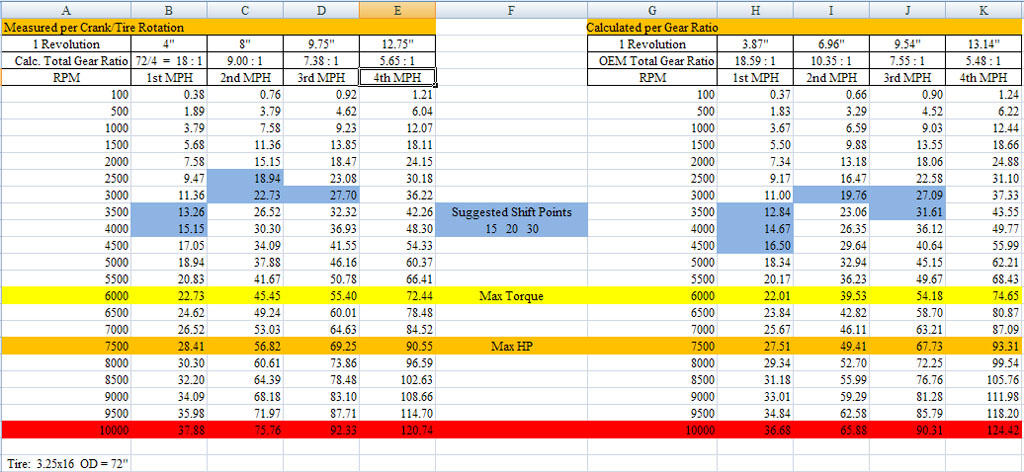

I made a spreadsheet with RPM vs MPH calculations based on the actual measurement of 1 engine revolution (rotor T to T) and the distance the tire rolled on the floor with me on the seat (Left Chart) and also based on the owners manual final gear ratio for all 4 gears with the measured tire OD (Right Chart). Both charts show 5000 rpm to be close to 60 mph. It was a rainy day here in Minnesota and I couldn't ride :-(I believe the formula on the speedo face means 2250 speedo cable RPM should show 60MPH on the speedo. If 2250 engine RPM was 60 MPH, then the bike would top out at 213 MPH at 8000 RPM!!
I confirmed this when I calibrated my speedo with a drill and GPS

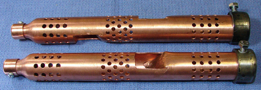

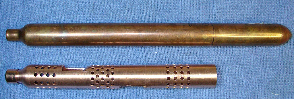

I thought it had the OEM baffles installed (I could see the ends of them) but when I pulled them for a cleaning I found that they had been cut off and only 4" long so it "looked" like there were baffles. Between what was left of my OEM baffles and what I could scale out from baffle photos I found and measuring the insides of the mufflers, I made my own using a couple plumbing Air Chambers from the local Menards ($15 including tax). Ain't the prettiest things, but they do work. :-)
