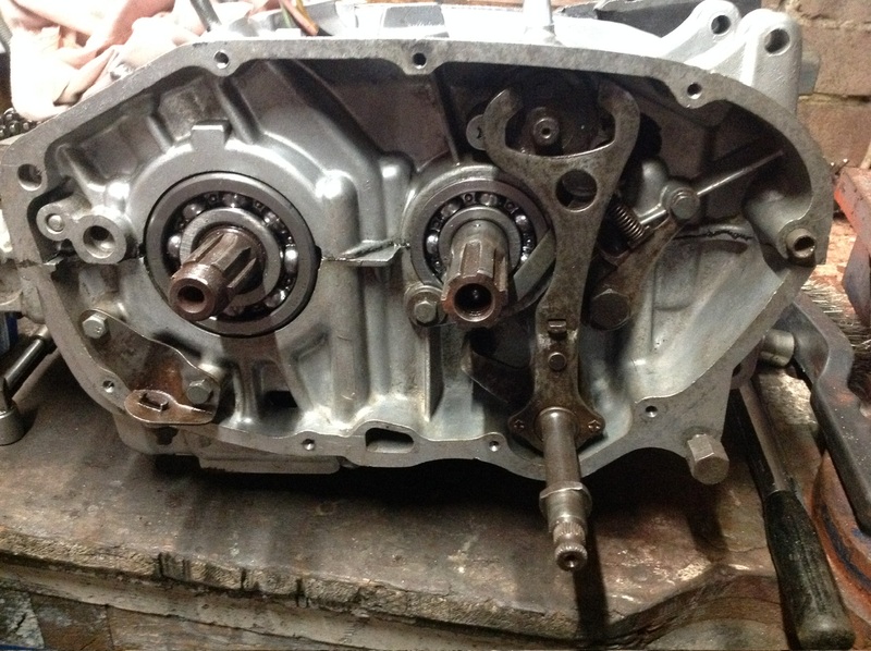

I’m as puzzled as you are about the sequence of gear selection. If you just rotate the selector drum by hand do the gears actually select in the normal correct 1 N 234? This is just a guess but, could the selector mechanism levers have been assembled wrongly or be bent. It’s a few years since I had mine apart so can’t quite remember how the levers rotate the selector drum.

I've checked and rechecked, the selector mechanism is correctly mounted.
I'm wondering because on the video below, it's a C72 exactly like mine and it seems to me that at the beginning of the video, it shifts into second gear by pressing the selector
https://www.youtube.com/watch?v=D1rHBE9Ba0Y
Didn't the first C72 models have a selection like the English bikes but with the selector on the left? I remember that the Kawasaki 750 H2 had a N12345 gear order.
The problem wasn't so much the reverse selection - I got used to it in the end - as the fact that in 4, if you press the pedal shifter gear, you're in neutral.
The groove in the selection drum has no stop but goes all the way round, which explains why you can do N1234N1234 etc. indefinitely, but I'm surprised there isn't a stop in 4?
Can a C72E owner (from 1963 but the year could be earlier on the video, it's a 1960) motor 72E 325XXX tell me what the order of his gearbox is? (This is not an export model but a bike originally sold in Japan).
I'm continuing my research but it's irritating me not to be able to find how and with what parts to have a 1N234 selection as it seems on the CA72/77.

Re: C72 from France
I could only find this one photo of the selector on my C77, it’s probably not a lot of help.
