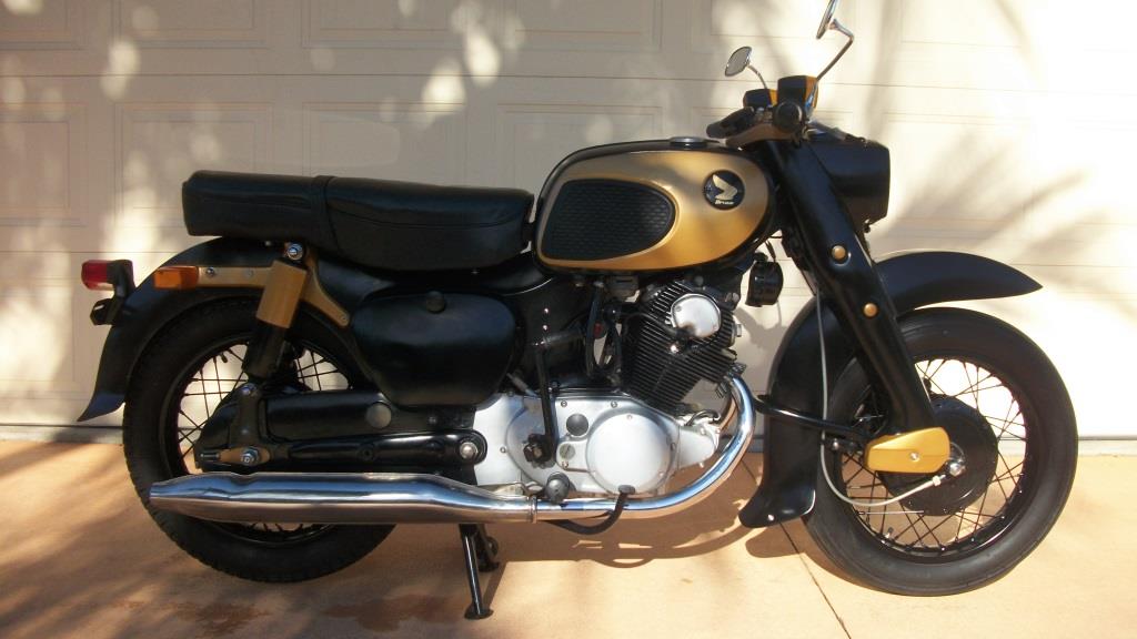

I have a pretty good condition '64 C72 that I've rebuilt and has been running just fine up until recently. Since the rebuild some time ago, I've been riding around the local streets with the bike running very well and pulling great for a little 250. The old girl has pretty open “Overlander” mufflers and a conical pod air filter - things to make the engine run lean. Admittedly the bike did sit around for a while - maybe 6 months, without being started while I worked on another project.

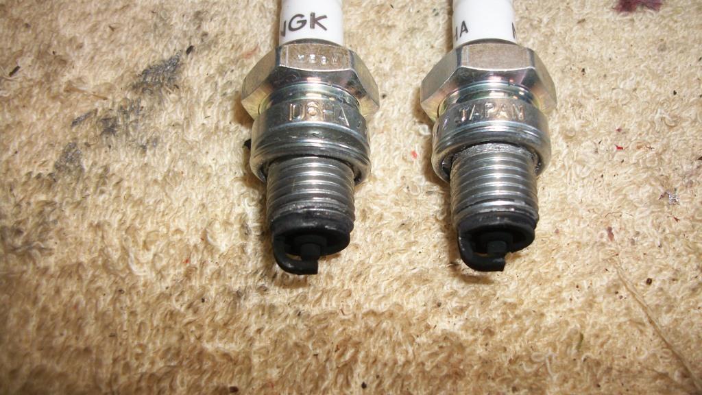

It has been over a year and I've continued to have problems with continual dry black sooty plugs. Even after a couple of minutes in the shed, the plugs were black and heavily coated with carbon. I've had the carb in and out a myriad of times, adjusting the float level lower and lower, but without success. Compounding this, there is not much info around on the Mikuni VM carb.
Because it looks to be running rich, I've dropped the float level in the bowl several times and also lowered the needle into the jet. I've had the float sitting in only a couple of millimetres of fuel in the bowl, but still the plugs carbon up. I’ve taken off the after-market, pod-style air filter, hoping that it may be undersized or restrictive, causing the problem.
I was misled by false hope at one stage, with the float very low in the bowl and a quick belt around the street for 15 minutes looking very promising. Pulled the plugs and all looked very good - nice and tan. However, next weekend when I started and ran it again, back came the sooty plugs.
I checked the floats for leaks, but they seemed good. I checked the needle (float valve) and seat and again, they looked fine. I checked the needle and seat by blowing into the fuel line, sure enough the needle (float valve) seated very well and shut off the flow.

- 100_2731a.JPG (128.26 KiB) Viewed 3074 times
- 100_2784a.JPG (90.87 KiB) Viewed 3074 times
