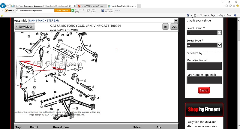

Post by brewsky » Sun Jul 31, 2016 11:13 am
From parts diagram....red shows where the parts attach

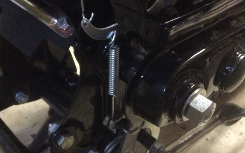

Post by Seadog » Sun Jul 31, 2016 1:22 pm
I'm not quite sure, but is this what you're looking for?
Mike546 wrote:Can someone take a picture of the way the springs are on the rear brake pedal for the switch. I just picked up a 65 and it seems to put slack at the switch when I press on the pedal. The shaft is pretty sloppy too if that makes a difference. The bike has seen better days for sure.

Re: CA77 brake light switch hookup.
Post by Mike546 » Sun Jul 31, 2016 2:09 pm
Seadog wrote:I'm not quite sure, but is this what you're looking for?
Yes that's it. Beautiful shape that bike. The spring you show there is hitting on the swing arm on mine. I believe the lower arm is sitting too far to the rear. I only see the one stop that holds it in position. Back out to the garage.
