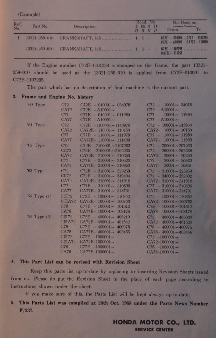

I have a CA78-103689. From the postings I have seen, they should be starting with 3XXX, but clearly this one starts with 1XXXXX and is titled in FL. Any comments?

a "3" prefix was for 1963. Honda changed the numbering sequence in 1964 and all bikes began with "10". Yours is later than '63.
How about some pictures?
