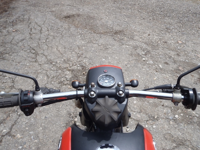

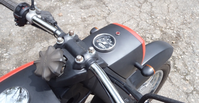

I received my cables back from Motion Pro. The custom speedometer cable cost $55 plus the cost of shipping the drive gear out to them to template and shipping my order back to me. The speedometer was around $50. Total build/work time was about 5-6 hours not including the wait time of drying filler and paint.
Motion Pro had no problem making the cables, they had the parts on hand.
I originally planned to mount the new speedometer in the same location of the old one, but as you can see I went in a different direction. It's easier to see/read and has a different look.
I ordered a cable sheath 34 inches, for the way I mounted the speedometer it should be an inch or two longer and maybe 1/2 to an inch shorter for mounting in the headlight bucket. Use this info only as a reference. If you order custom cables measure the lengths yourself.

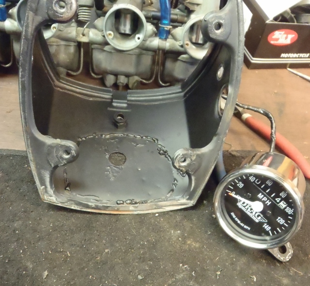

To modify the headlight bucket I cut off the raised lip using a hand grinder and cutting wheel. I templated the hole to a piece of sheet metal which I MIG welded in place after ensuring a proper fit and drilling the hole for the cable to pass through. If I had mounted the speedometer in the bucket I would have cut that hole before welding also. I ground and sanded down the welds, added a little body filler, sanded the filler, and painted. I'm posting some full bike pictures in the project folder.

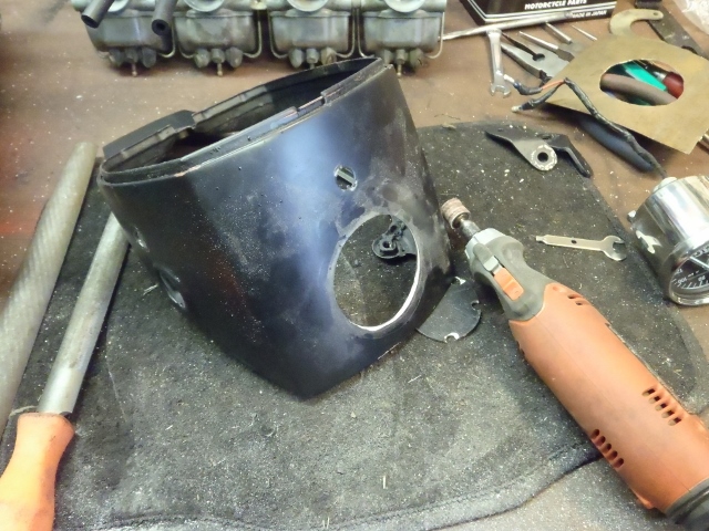

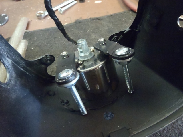

Generic Universal Speedometer Mouted in headlight Bucket
A couple of weekends ago it was raining, so I decided to try mounting the generic universal speedometer I mounted to the handlebars into the headlight bucket. It took about an 1 1/2 hours.
I cut a undersized hole in the blank that I welded to the bucket, then slowly filed it the the correct size. I achieved a nice snug fit. I straighten the brackets I made to hold the speedometer to the handlebars and installed bolts to hold the speedometer in in place.
